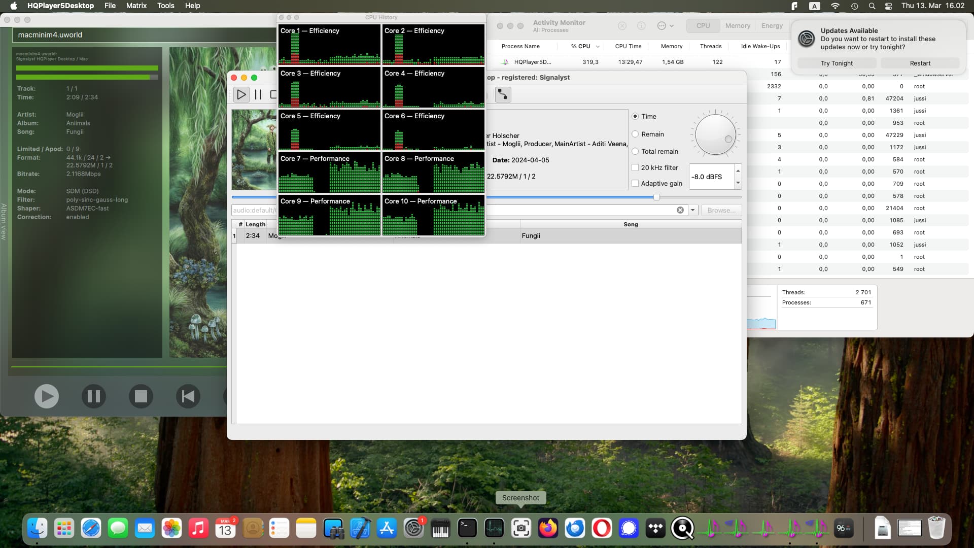

Here’s now some testing results with base model Mac Mini M4…
Can the efficiency cores contribute more to mitigating the lack of GPU support?
Not in the way as on other platforms, since Apple doesn’t allow core pinning. But they are still considered by HQPlayer.
So, do the spikes indicate that efficiency cores are only being used by filters here? Using system scheduler?
Amazing. Looks like you are getting 1x → DSD512 with 7EC-fast, default filters, AND dac correction. Does this also work with Nx, 192k/24? And while I assume that the Sinc filters won’t work, what about ext3?
