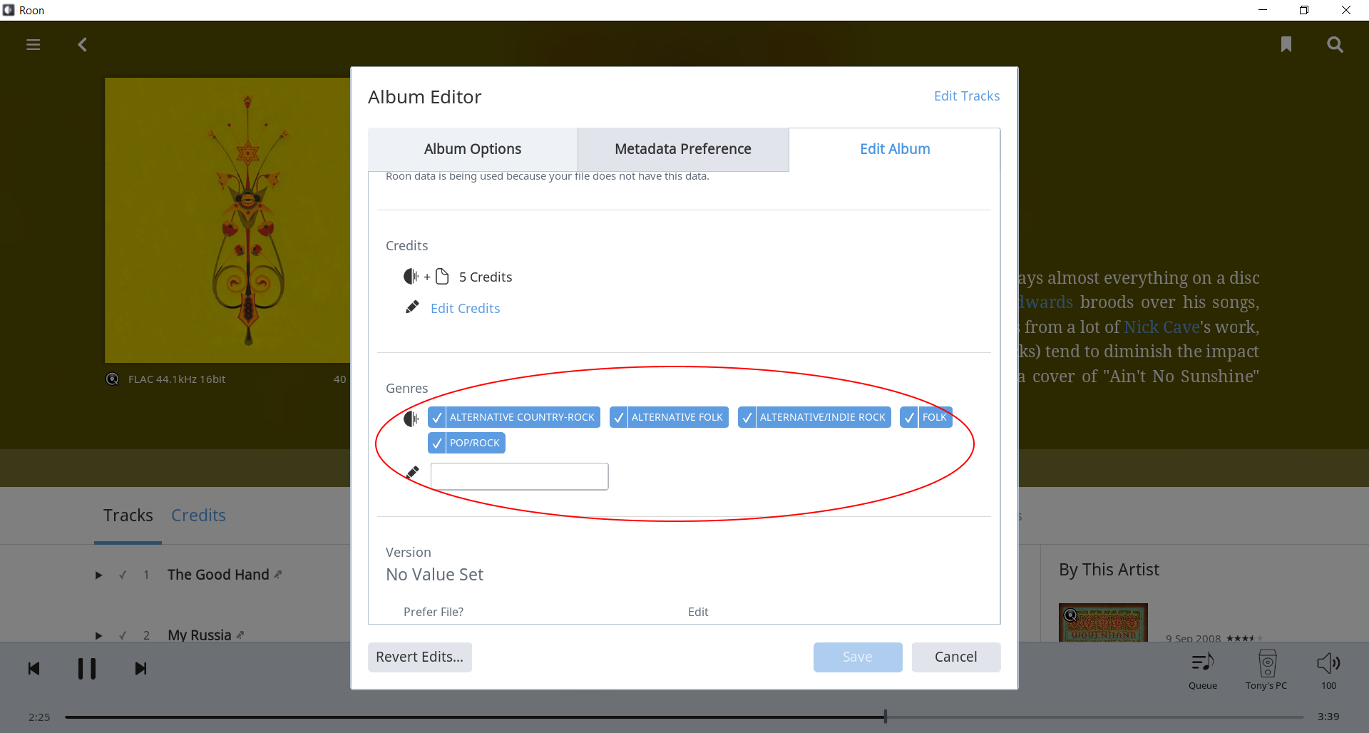

what is the difference between these two indications or their function?
One’ a genre one’s a tag I think.
Just ask myself if both are needed
I wouldn’t think so. Tags are for marking things that aren’t already system identifed.
The blue one is a genre. Roon knows what a genre is and certain parts of its logic in radio, discovery for example will use that knowledge to alter the behavior of the app.
The green one is just a string of text. Roon has absolutely no idea that you think it is a genre and will not use it in that way in any part of it’s logic. It is useful for grouping and searching. Maybe there is something I don’t understand but I don’t think it serves any useful purpose to duplicate the name of a genre in a user defined tag.
I would almost think that the right (see photo, light green) is not necessary because with tagged own albums the left (blue) appears automatically. Conclusion would then be, when you add Tidal albums to your library then input the genre via ‘edit album(s)’, if you do not, I have noted that the added Tidal albums not appears after menu choice ‘albums’
I think there is a basic confusion here. The green button is not creating a genre tag. It is just not a genre even if you use the same name as a genre. So, yes, the way you are using the green tag does seem to serve no purpose. I use the green tags a lot but never for genres.

I don’t really understand what you are trying to do. You seem to be creating a bunch of personal green tags that look exactly like blue “genre” tags. It doesn’t make any sense as you seem to realise yourself. If you want to create a blue tag that behaves like a genre you need to go to a completely different screen. You cannot do it from here. You need to go to the album editor:
Yes, I have done a lot of useless work.
unnecessary loading of the system
It’s your roon so only you can make that decision but I would be inclined to say yes delete them. They are not doing any harm except when you expect them to behave like a genre and then they dont’. It is the same drill. If you want to add or delete blue genre tags you can do that from the artist screen. Not this one.
