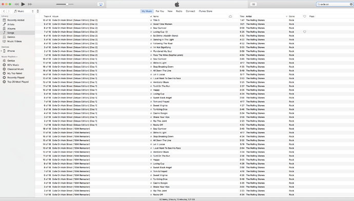

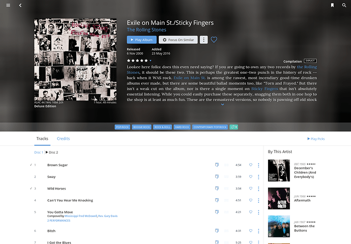

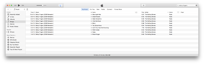

OK, here’s one. Somehow Exile on Main St. and Sticky Fingers are showing up as a 2-disc set. Will post iTunes and Roon Captures

It’s the default iTunes folder structure:
The Rolling Stones > Exile on Main Street [Deluxe Edition][Disc 1]
The Rolling Stones > Exile on Main Street [Deluxe Edition][Disc 2]
The Rolling Stones > Sticky Fingers [2009 Remaster]
Sticky Fingers is also showing up in Roon as shown above
I have 3 versions of Exile:
The one above
The 1994 Remaster (not showing up)
The the Japanese SHM SACD (showing up)

As you can see here Roon doesn’t like the way that iTunes named your folders for the multi-disc album.
If you’re brave :grinning:, you can use Roon to separate the incorrect 2 disc set. Then you can then combine the proper 2 albums to create the 2 disc set. This is assuming you don’t want to eventually correct the original folders and tracks.
To be safe, you may want to quit the Roon Core, and back up your Roon Library Folder. Also, backup your Stones music files. *** added by Greg to save my butt if something goes wrong. :stuck_out_tongue_closed_eyes:
If you view the Exile / Sticky Fingers 2 disc album, click on the 3 dots, then Edit and then Fix Track Grouping. Now, on the left, you will see the two discs. Click on disc 2, then click Remove Disc. Don’t worry, it won’t delete the files in your folder. Now, on the bottom right, you can Create Album, assuming everything looks right.
By selecting the Artist, The Rolling Stones, you should now see the albums separated. You can then right click on the proper 2 albums for the disc set, click Edit on the top right of the screen and then Merge Albums.
For fun, and as an experiment, I found a 2 disc set in my library that was properly indentified. I edited it and selected Fix Track Grouping. I then clicked on disc 2 on the left, and then clicked Remove Disc. It now showed disc 1 of the set, with the correct tracks. I Created the album. Now I had 2 of the same album under the artist. One had the tracks from disc 1 and the other had the tracks of disc 2. After that, I selected both albums, click edit, then Merge Albums. I Created the 2 disc set and was back to where I started. Cool, eh.

Greg, belated thanks for this. I didn’t have to use this approach earlier. Fixing naming anomalies in iTunes would usually do it. I did have to implement your approach today for a Mosaic Django Reinhardt box set and it worked like a charm. I don’t think I would have know to Control click on the 2 albums to merge if you hadn’t suggested it. Thanks again! Tim
