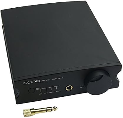

If you are interested in a low cost implementation of these chips, try an Aune X1s:
I have a couple and am very impressed with the sound quality. they also seem to be completely indifferent to the computer feeding the USB. I drive one from my Mac Pro and the other from a Raspberry Pi with no noticeable difference in sound quality in an informal A/B comparison using Roon and the same amp/speaker combination.
