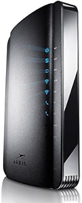

My Cable company has this all in one box
it is the Modem, Phone and Router.
I connect the coaxial cable from wall into this box. One CAT6 goes to my computer. One CAT6 goes to my NAS BOX. Final CAT6 goes to microRendu.

I am not sure if my all-in-one Arris TG1672G can go bridge or not.
Some on the Time Warner Cable forum said in 2013 that it can. Damn, my box is old.
