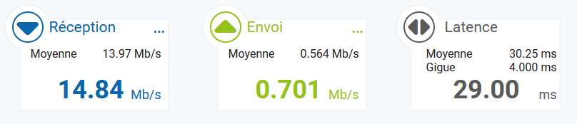

Thank you very much. For your information, here are my values:
Which means I may be able to go as far as « Balanced (lossy) ».

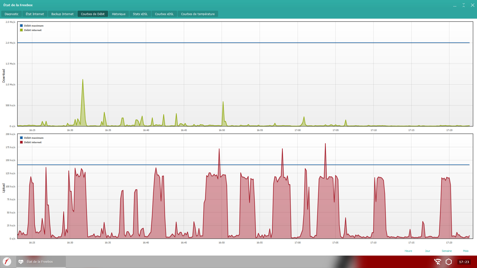

I have no idea what I’m looking at
These are network traffic curves. The upload rate is close to the maximum, but it’s okay.
Well yes, I understood that. But I don’t know which is which, what the traffic is, what the peaks are, or if it shows behavior where ARC is working or not.
Oh? Okay. The upper part is downstream traffic, the lower part is upstream traffic. The blue lines are the theoretical maximum speeds of my connection. The « little mountains » on the bottom correspond to the start of playback of a new track in my playlist.
Ok, but is it working in this case?
And the downstream to the phone (which I suppose is in the cell network?) is not shown?
Yes, it works. And indeed it’s only the server-side curves which, in my case, is the limiting side. I had a decent 4G connection on the client-side but I don’t have the monitoring.
I see, cool then. Interesting to see the pre-fetching/caching behavior, thanks for this
