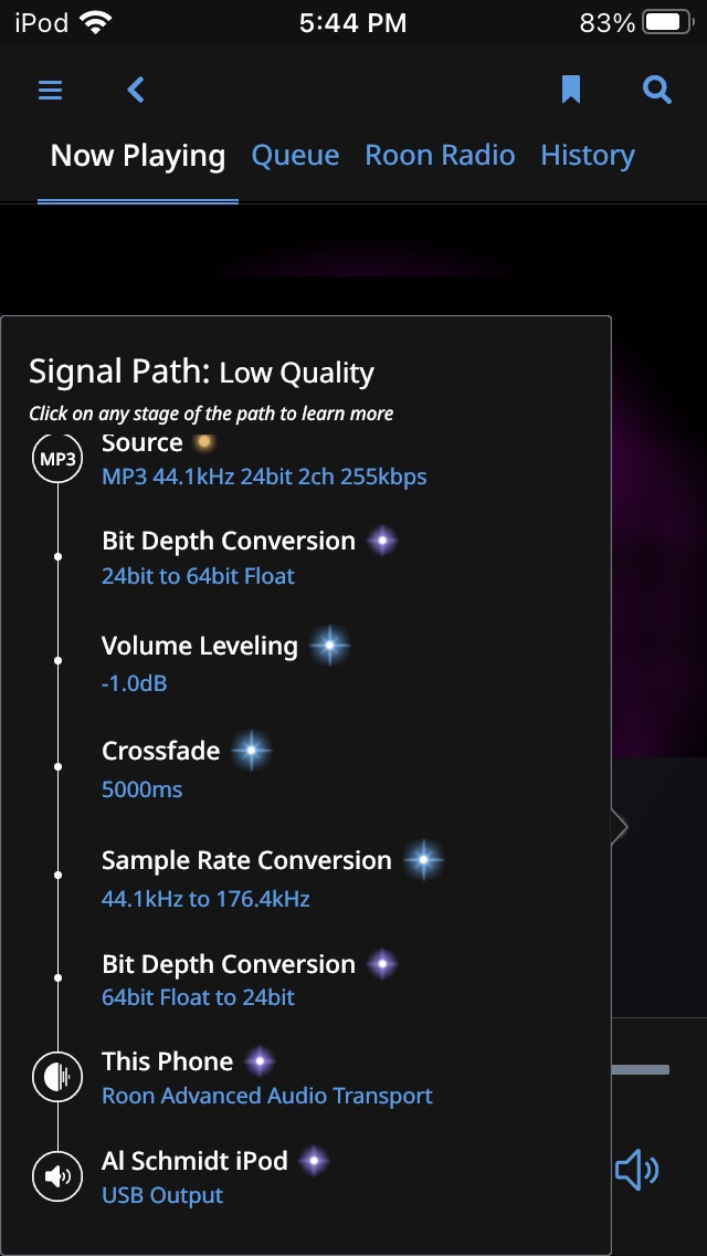

You can however get bit perfect streaming to an iOS device if you add an external USB DAC/amp. As I’m sitting here typing this reply on my iPad, I’m streaming from Roon to an iPod Touch that’s connected to a FiiO Q5S and a pair of planar magnetic headphones. I’m even upsampling the stream and controlling it all on the iPad. Here’s what my signal path looks like:

On the other hand, from the image above, it seems you can go higher output on an iOS device. My point is I care about seeing Roon more mobile friendly by having their app support variety of hardware to their limit. For example, Roon can have a pro version of mobile where it supports higher streaming and can work over WAN . that would be a dream.
