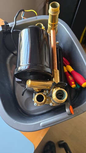

Once I’ve fixed this pump I’ve got to disconnect and ship the other one off for repair. Both pumps failed on the same day!!!
There may have been
@#£@% words used.
Yep, with a knackered pressure switch assembly apparently.

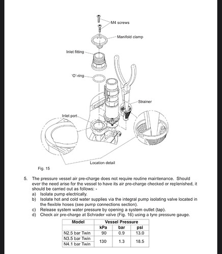

Now in bits whilst I triple check I’ve put all the new washers in, cos there’s one left in the rebuild kit…hmmmm
It’s a new pressure vessel as that’s what went wrong last time…
I will check the strainers, good idea.
New ties on the reed switches.
New screws, new washers.
