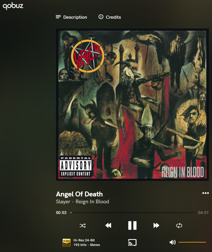

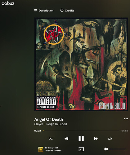

I picked this up on vinyl only a couple of months ago at a record store in country town Victoria, Australia. The guy had this and South of Heaven so I snapped both up - he told me he’d sold Seasons in the Abyss only the week before. All pristine original UK releases. Thrash is my guilty pleasure.
