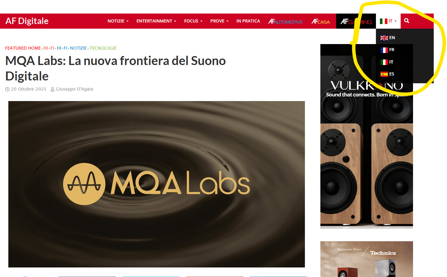

I would like to bring to your attention the article I wrote about MQA Labs, published in an Italian web magazine. Should you be interested, here is the link:
https://www.afdigitale.it/mqa-labs-la-nuova-frontiera-del-suono-digitale/
Regards,
Giuseppe

I had the chance to try out QRONO and other MQA Labs technologies, such as FOQUS and Endura. The article was already quite long, and I didn’t want to make it too heavy, but I plan to write a second part focused on my listening experiences.
What I can tell you is that all these technologies offer perfectly audible improvements, and I consider them genuine enhancements. While technologies like FOQUS and Endura are DAC independent, QRONO requires specific implementation. I tested it with the Lumin P1, where it provided a benefit that I consider significant.

Is there an English translation? I would love to read. I also agree with your responses to mjw, especially with regard to critical listening. There is a big difference between preference and accuracy which leads to confusion, especially if one does not know what a particular instrument should sound like.
