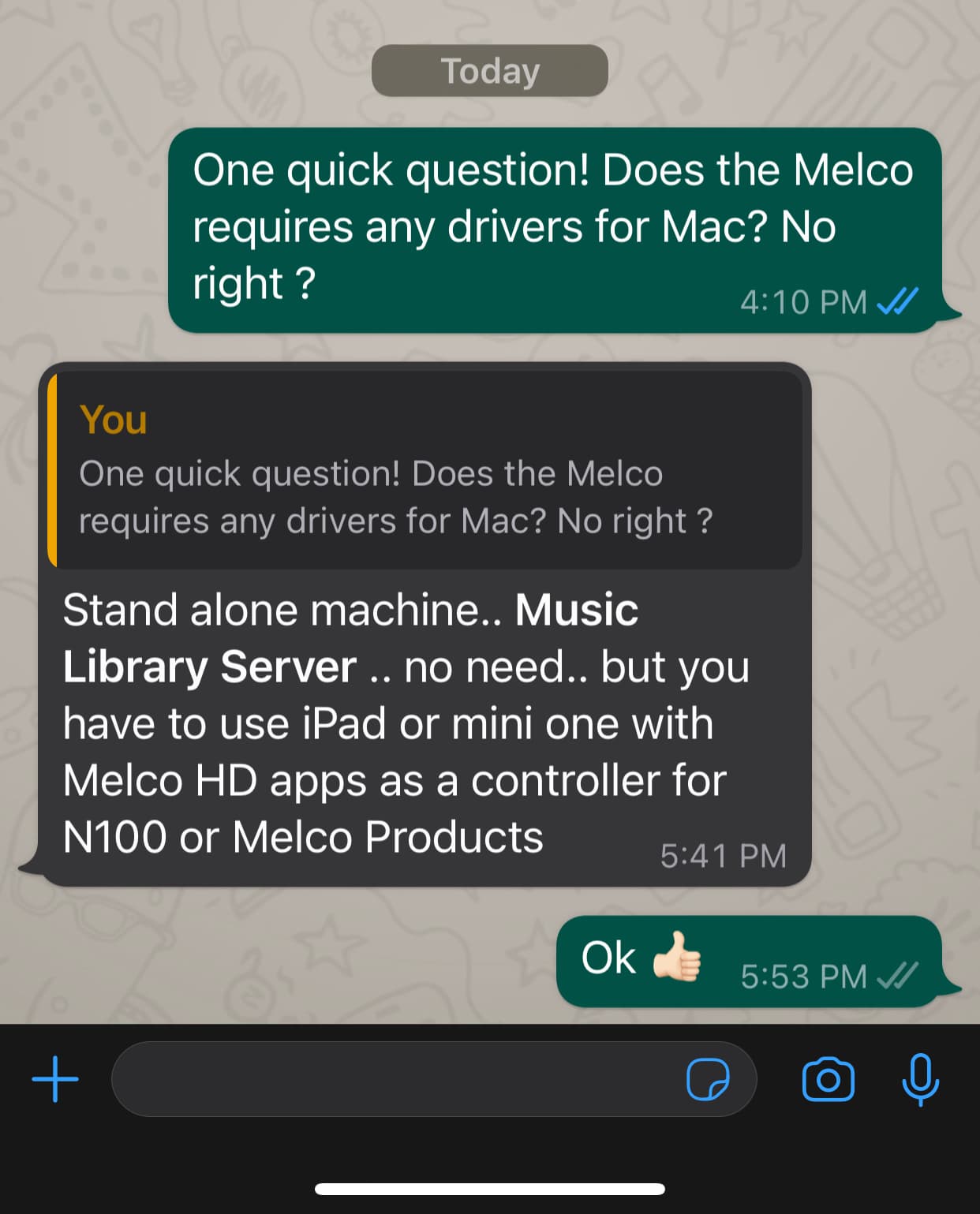

Looking at the manual, it doesn’t show any driver installation
Will ask distributor in HK also. Replied, is stand alone no drivers
Not for Mac. Jussi is asking about Linux driver.
