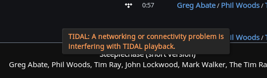

I still have the “Network error” messages… :cry:
Thanks Kenneth,
Yep, looks fine, should be working :confused:. mmm, we could try limiting CPU clocks at each frequency and see if any of them have any effect on this. But, lets check network issues first.
Can you elaborate on the errors you are receiving? And, are you using USB WiFi or onboard Ethernet on the Neo?
Hello Dan.
I use onboard Ethernet only directly to a Gig_switch with the Roon Server (Intel NUC) connected.
This is the error message:
I use Armbian, and it works fine with the NanoPii and Roonbridge
Our image is intially built with ARMbian build tools. It contains the same kernel, modules, uboot and firmware as per the ARMbian image.
@Kenneth_Rosenkrantz
I’ll build a 3.x Neo image, see if this resolves the issues you are experiencing. I’ll let you know when its ready for testing.
