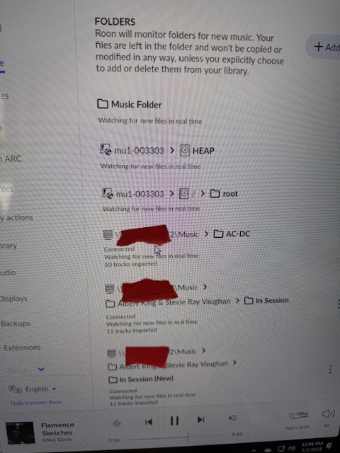

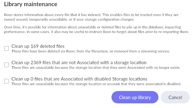

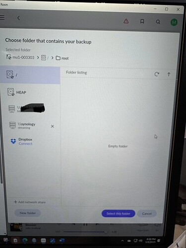

Had power outage that required me to reset all of my devices and basically start from scratch redoing my network and I have limited IT skills. I have an xfinity router set up up in bridge mode, a LUXUL EPIC 5 ABR5000 router, a LUXUL switch XMS-2624P, a Ruckus Zone Director 1200 with two 710 WAP’s, I have a Synology NAS DS918+ with 48 TB of storage using Seagtae Iron Wolf internal drives. I have a GRIMM MU1 streamer. Thankfully I had things backed up but it took me a week to figure everything out…well, almost everything. My issue and where I need some help is the working relationship between my Nas and Roon. When I reset my system it was giving out .5.114 IP address to the synology nas, problem was everything else was on a .0.## IP address and as a result my library went from 46K songs to 3K songs and Roon could not find the NAS as it was on a .5.114 IP. Therefore, my Roon/Grimm was not connecting to the NAS. Miraculously, after much trail and error I did my network up and after actually trouble shooting with synology they suggested a .0.## STATIC IP address. So, I did that and instantly they connected; however, my music was in a nice Music file and now it looks like

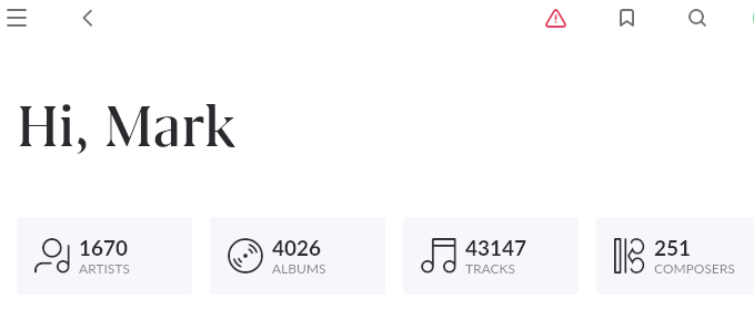

I can’t figure out how to get my original 46K songs back as now I can only see 43K after adding all the music folders one by one. To reiterate I am seeing my synology now that i have gone back to .0.### it is just that they are on a .5.### file from the synology…I think, because my system is still showing 6.5TB’s of music and I have not backed up.
