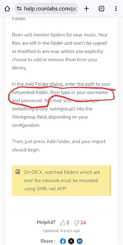

Not sure what you mean by “map my drives,” but the standard way to access a NAS from Roon does not need any intervention when the Roon server computer restarts.

I have to do this every time my computer restarts.
When my computer restarts, the drives have a red x next to them, i have to right clicknand connect to the drive. Maybe map my drives is the incorrect term.

I don’t use a NAS currently, but I never saw that when I did. My suspicion is that something changes in your network when your computer restarts that requires remounting the remote file systems. If you know how to do it, it may be worth assigning fixed IPs to your Roon server computer and to the NAS.
