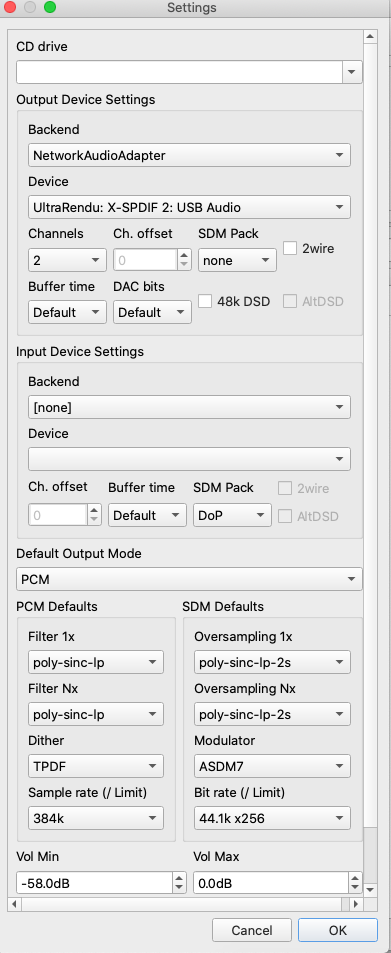

And the view from HQPlayer’s Preferences panel:

Jussi, for some reason, I cannot use the volume knob in HQPlayer. The minimum and maximum volumes are set here:

You have set maximum volume to be -50 which is pretty low. And your minimum volume is higher than the maximum so it doesn’t have effect. Thus you are locked to fairly low -50 dB volume level.

I set HQPlayer on Roon for fixed volume, and adjusted the min/max settings based on Jussi’s recommendation, and I am now playing.
