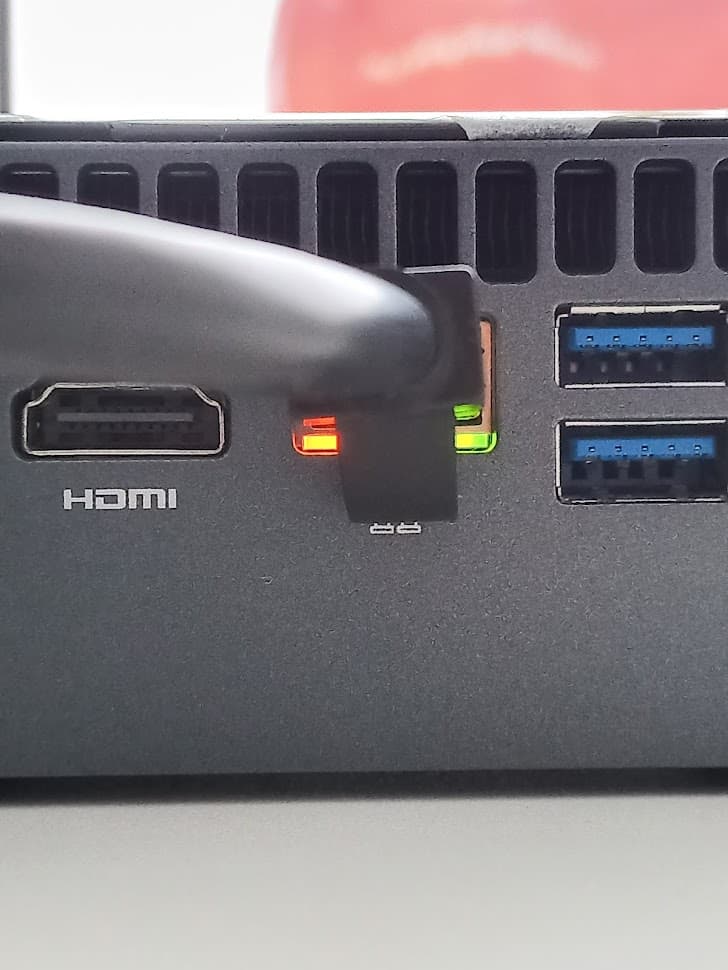

Okay, thanks. Is the LAN/Ethernet light on the front of the NUC? The power LED comes on, as does a light that looks like a cylinder on the left…
LAN indicators are on the back, right on the LAN-port. They should look like this:
Sometimes my NUC loses connection cause the cable connector does not fit tightly into the port (spontaneously, under the weight of the cable it moves to the left or to the right) or I move NUC accidentally.
