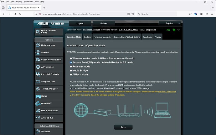

To put the Asus Router into Access Point mode, in the ‘Administration’ page:
This will mean that the Asus router will act as a switch and a WiFi endpoint - but it will not give you access to any of the advanced router cabapbilities if that is what you want. It will, however, give you the WiFi capabilities.
