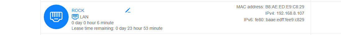

Can you see your network from within the B628’s administration page? What local IP addresses are assigned to your LAN? Still 192.168.8.xxx?
does your core still reside at 192.168.8.107? does “ping 192.168.8.107” reply or time out?
I’d be shocked if it got the same IP address.
I would log into your new router and see what IP was assigned.

2022-12-10_15-47-47
