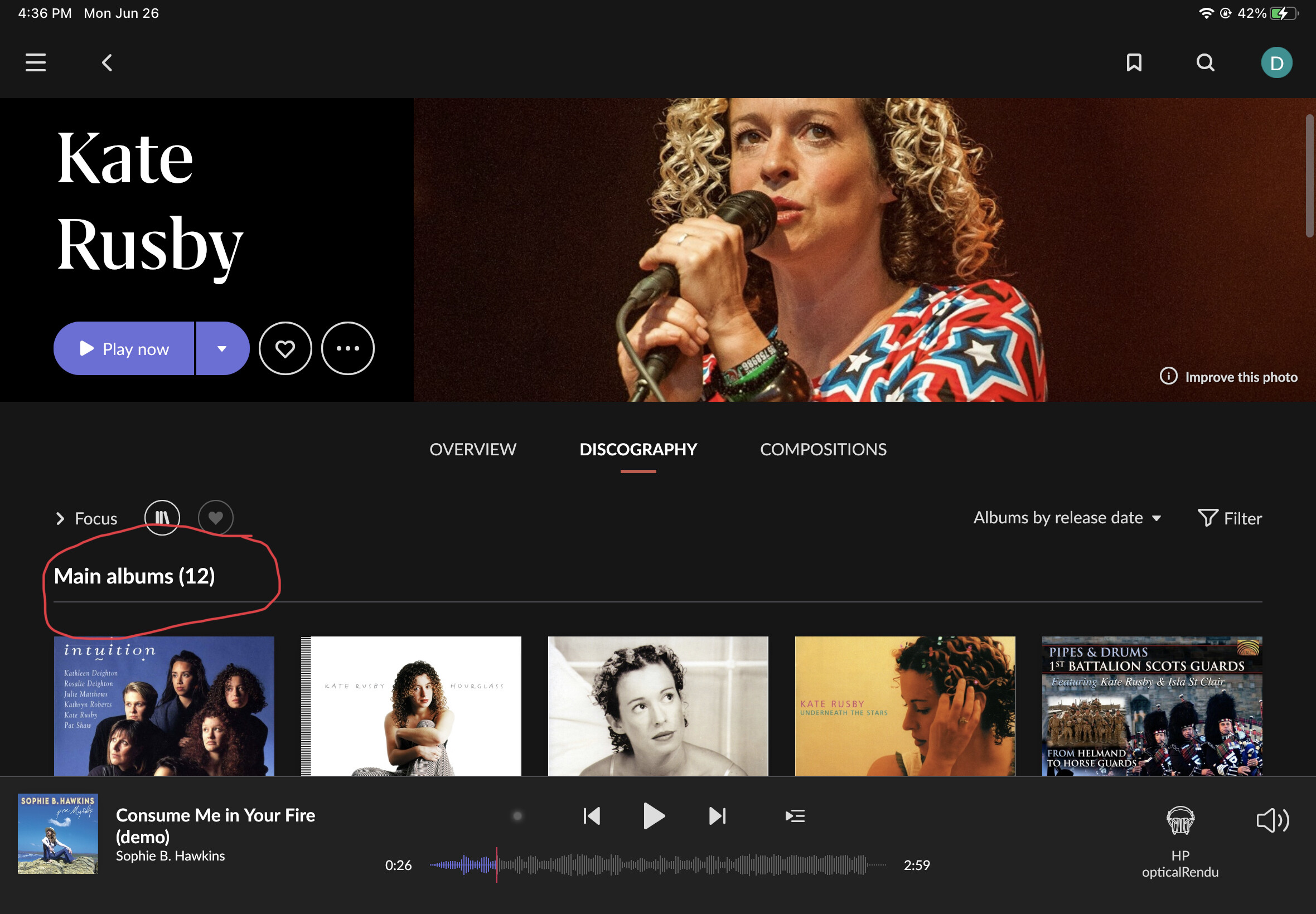

Once again:
“I have LOTS of music that is not on any streaming service I’ve found, for example, my beloved Kate Rusby that I’ve been listening to all week.“
There are more than 12.
19 by my count.
Those 12 are on Qobuz and Tidal, so your claim that she isn’t on streaming services isn’t correct.
Well I’m sorry I didn’t specify that they are not all there. So only 36.8% are not there. Happy now?
