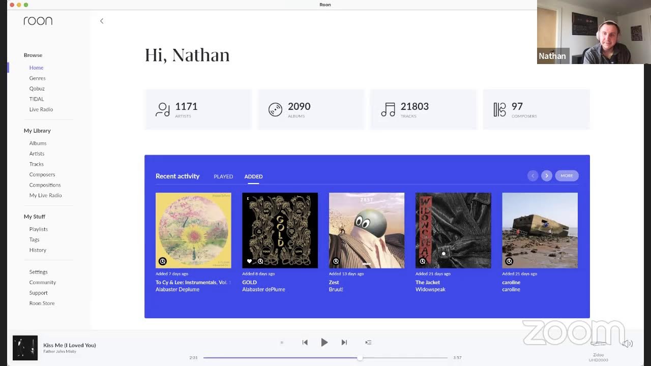

This video for new users might help a lot.
Thank you Andrew
