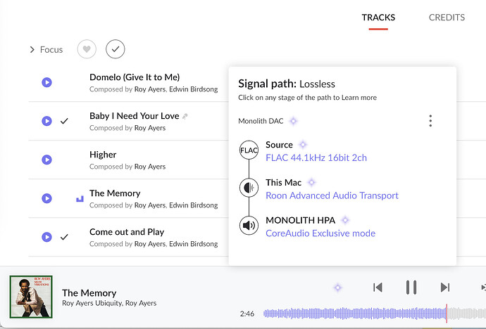

Anyhow, I need some clarification on something. When I play through AirPlay, it shows the signal path as High quality, however when I plug in my DAC and play, it shows Lossless
So from what I’ve read on this forum I understand this is because AirPlay although it is 16/44, can’t be guaranteed to be Lossless. Is this correct? And is my assumption AirPlay serves music at 16/44 (I was hoping I could see somehow, but it doesnt show the codec/rates Airplay is playing, well I can’t find it).

Hi, AirPlay is lossless with 16/44 content, so don’t worry and have fun listening to your music. And avoid falling in the famous audiofoolery with higher is always better and the right color of indicator has to be shown. Enjoy your listening and don’t try to solve problems you not have.

It is only related to Apple Music and not the AirPlay protocol. Roon is sending lossless over AirPlay.
No that’s only for Apple Music when using AirPlay 2 and not AirPlay in general and is a well known issues or feature purely of Apple Music
Roon defines it the way it does as some devices such as an Apple TV will resample to 48k and it won’t report it and also AirPlay relies on two clocks not one like most transports. So it uses the oneon the sending device and on the receiving device and they might not be exactly in sync so AirPlay can alter try the output to fix this. It is however more often lossless at 44.1.
