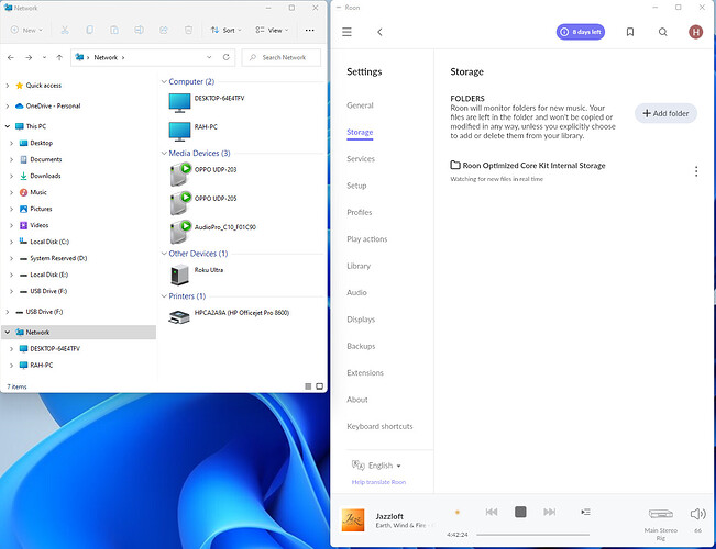

I’m still having trouble getting a music file placed into or onto the Music Storage SSD?
I have both a Windows 11 PC desktop and a MacBook Air laptop.

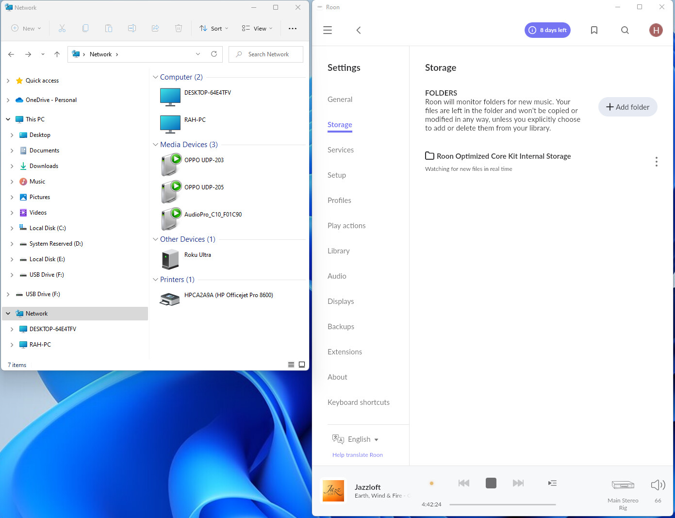

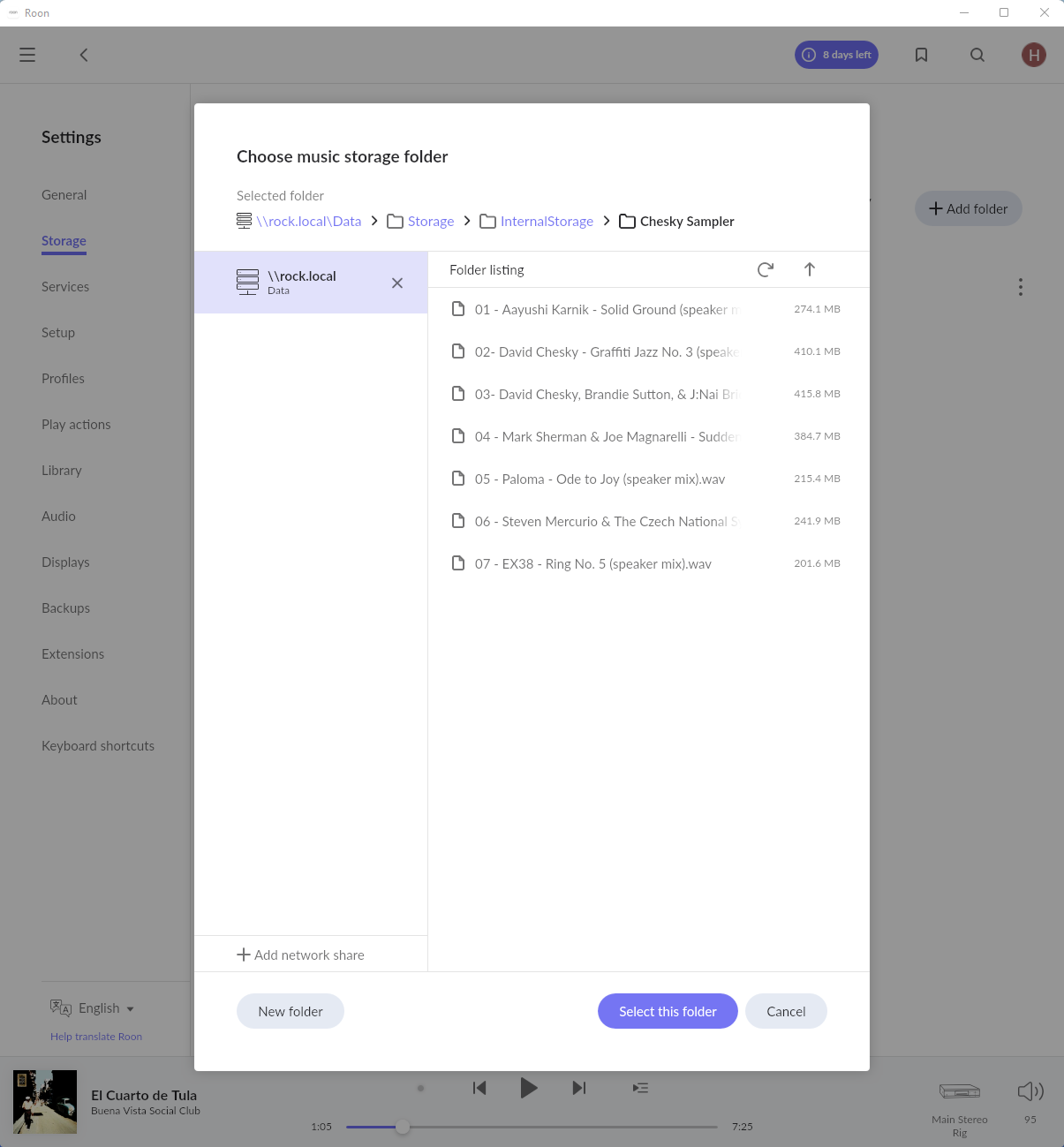

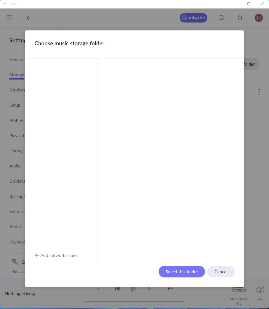

On my Windows 10 machine I went to Roon settings/storage and added a Network share and typed in: smb://rock.local/Data
I also then created a Chesky music sample folder but if I drag a file from a USB thumb drive and try to drop it into the Chesky folder Roon will ask me if I want to add music to the Internal Storage but then Roon will hang attempting to move the file and I’ll have to close it?

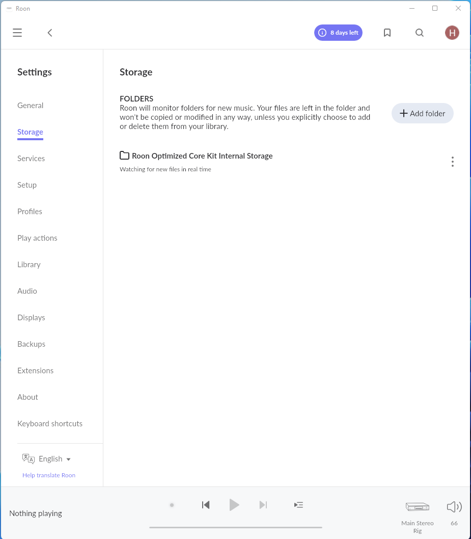

You don’t need to do this since that’s telling your Core (ROCK) where to find music, when it is (or will be) on the local file system.
As I said earlier, ROCK has already provided a file share on your home network. What you have to do is connect to this from Windows (not the Roon app) so you can copy files from the Windows PC to the SSD in the NUC.
To do this you’ll need to open the file explorer, Windows network. From there, you should find ROCK. Then copy across your files. I can’t be more precise as I don’t use Windows.
Copy files in small batches or stop Roon Server while you copy your entire library. For best performance make sure everything is connected to Ethernet.
In File Manager, copy to that Share like you would any other Share.

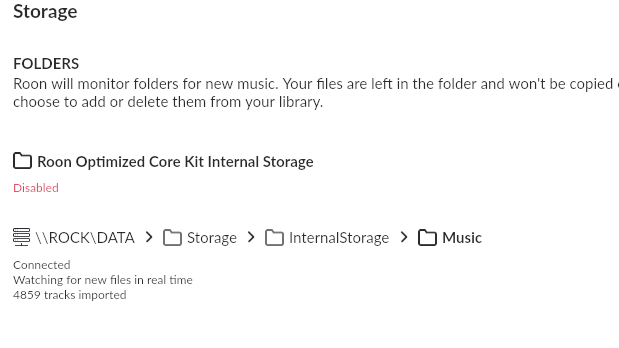

Also, don’t added nested directories to Settings==>Storage. If you add folders that are nested under Internal Storage directory you will get duplicates.
In your setup, as I see it, this is all that is needed.
Alternatively, if you want to explicitly use nested subfolders, then disable the Internal Storage in Settings==>Storage and add each directory you want.

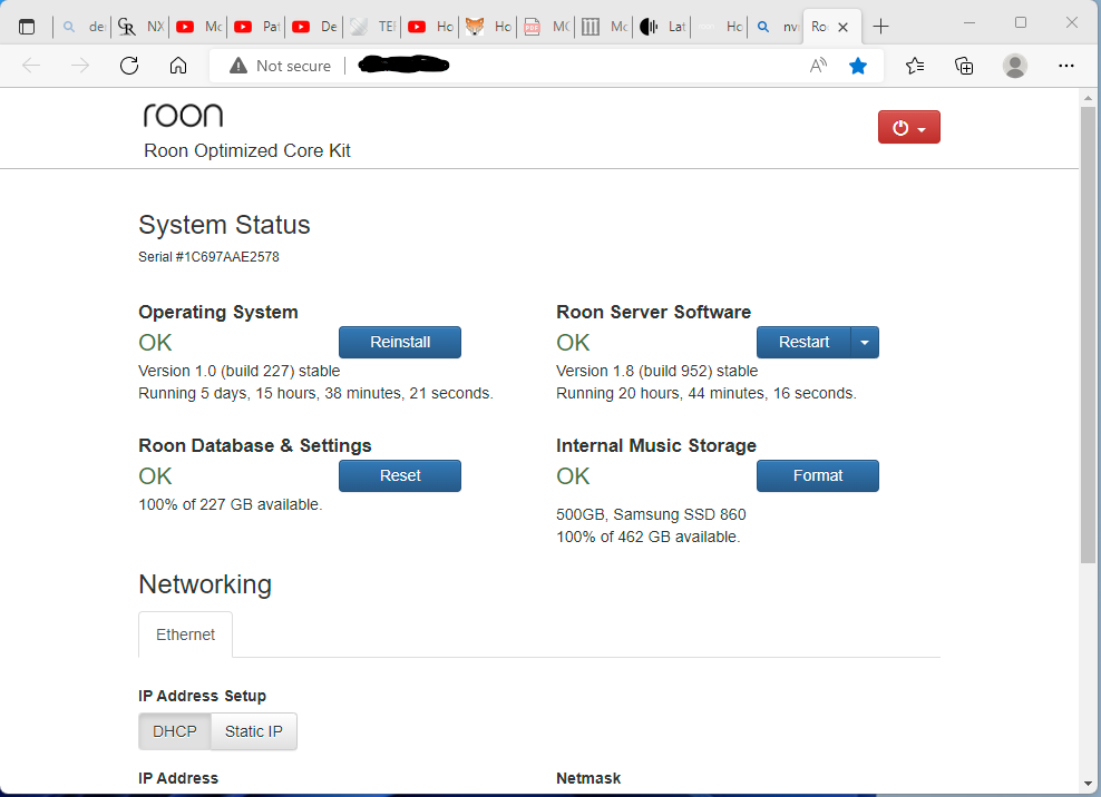

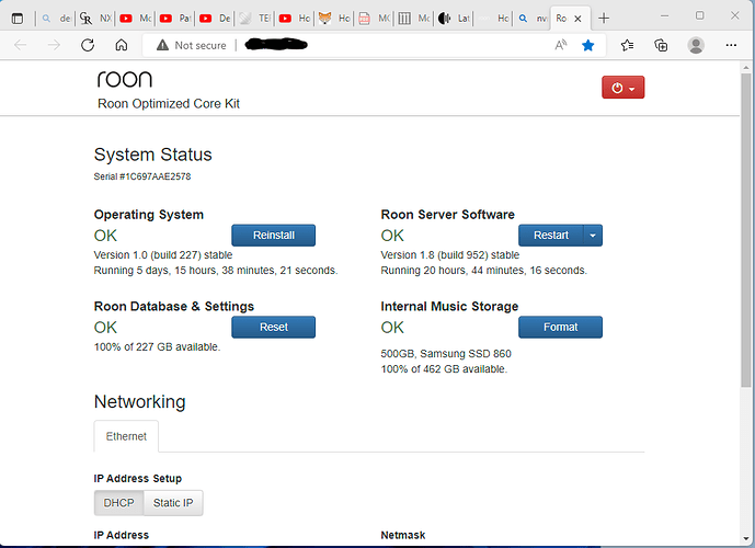

Hello and welcome to the community. I may be missing something here and did not see it mentioned but your web ui display shows the format button under Internal Music Storage. Did you hit that button to format the drive? Roon has to format the drive before it can be accessd.

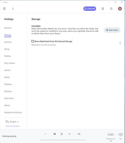

On my Windows11 desktop I went, and enabled network sharing and I also removed the added nested directories from Roon app Settings>>>Storage.

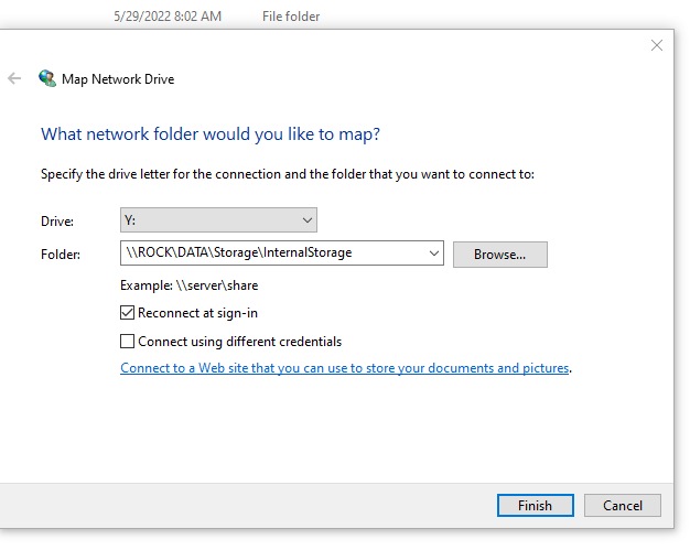

You don’t need to enable Sharing on your Windows machine, but it won’t hurt what you want to do here. You are sharing the directory on ROCK. ROCK has already exposed that for you, so there’s no problem there.
On your Windows machine
That is this in ROCK
Just use File Manager on the Windows machine to copy your music there and you’re GTG.
You can have as many folders as you want in Settings==>Storage or you can dump everything into that one directory. It’s however is clear to you. Just don’t add a directory that is nested under a directory that is already in Settings==>Storage. That’s how people end up with duplicate albums listed.
Like I said up above, if you want to have individual directories and they are nested under your main directory, then disable the main directory and add all the individual directories you want. See my post where I use the example of the Music directory that is nested under the main directory.

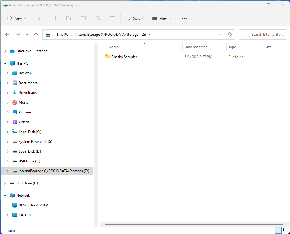

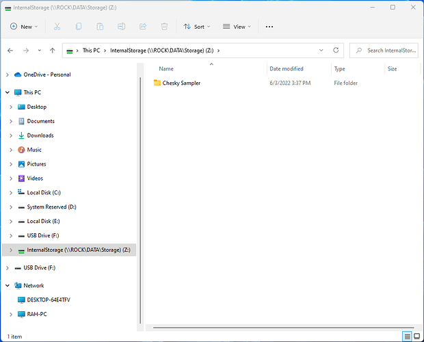

In the Finder, open Network.
Then go down the path Network > rock > Data > Storage > InternalStorage
Create folders in InternalStorage and copy music files into the folders according to how you would like to organize it. If you created the Chesky Sampler folder already, you can go ahead and copy files into it.
If you just want to use InternalStorage like a top level folder on the SSD, you don’t need to do anything with Settings > Storage in the Roon app. You can change it later if you want to organize things differently.

I think everything with my settings is good to go now. I can access the NUC Music Storage SSD from both my W11 desktop and my MacBook Air.

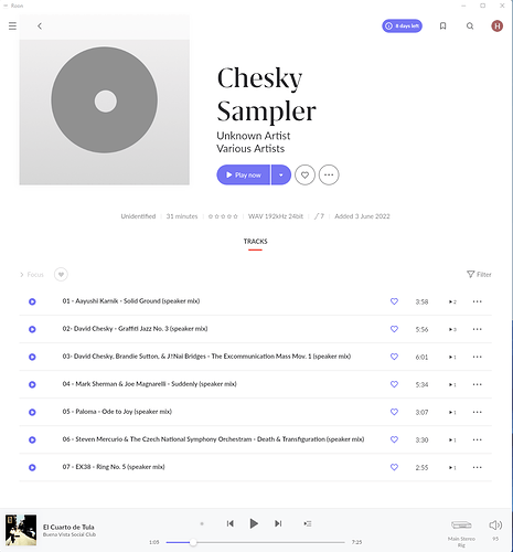

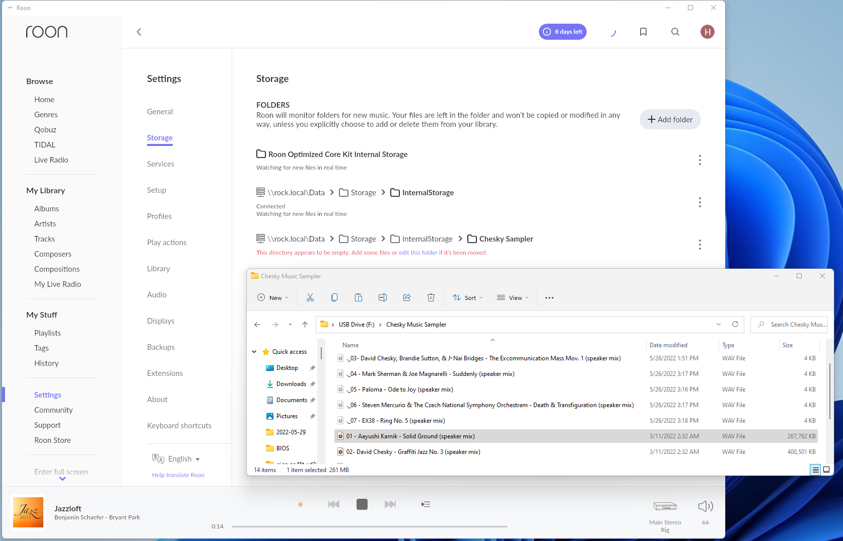

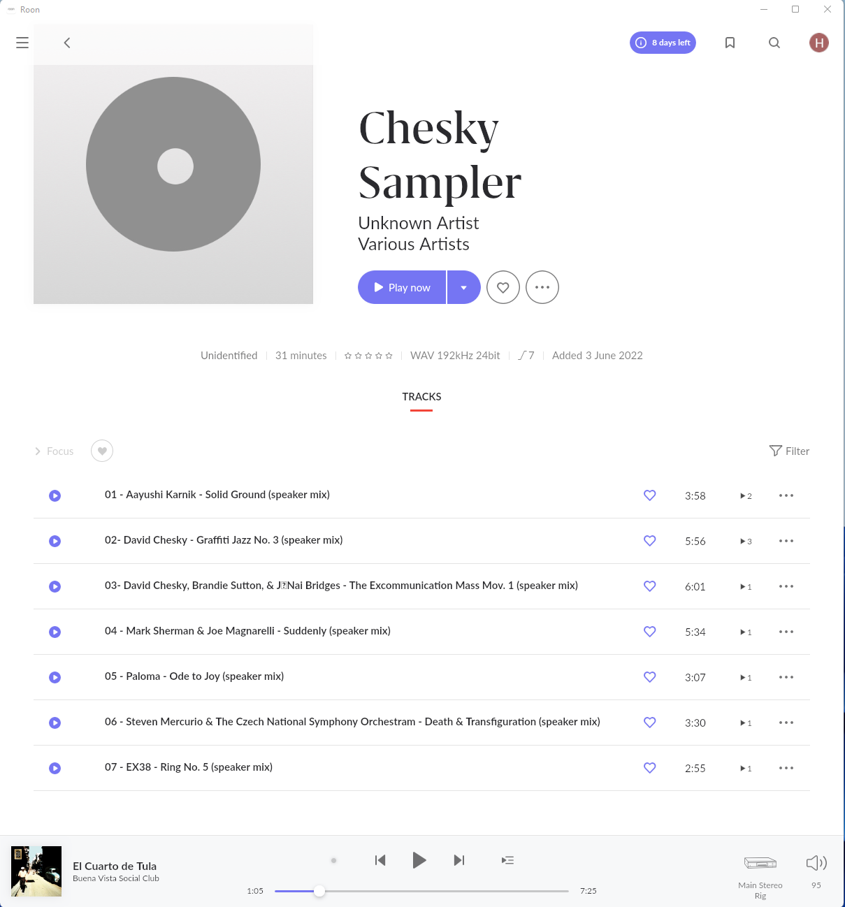

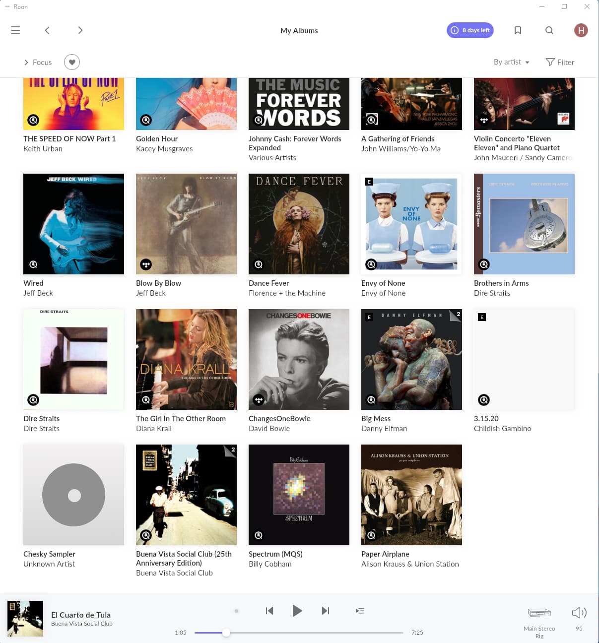

Is it normal for music files placed in NUC/ROCK music storage SSD to not to have any associated album or song art like the saved albums from Tidal/Qobuz?
mjw
(Father! Father! Resist not! Let us destroy the core! Set us free!)
14
The reason there’s no artwork is that the artist is “Unknown”. That’s most likely because the files are WAV and these don’t include any metadata. You can attempt to identify the album manually by clicking on the ellipsis, and choosing Edit. However, given the title, I think it is unlikely you will find the release.
@Pol_R
Usually downloaded albums include album cover image files for music players to use.
This download doesn’t include an album cover so Roon displays a generic image. You can add your own if you’d like. Copy a jpeg file into the folder, and give it the same name as the folder.
