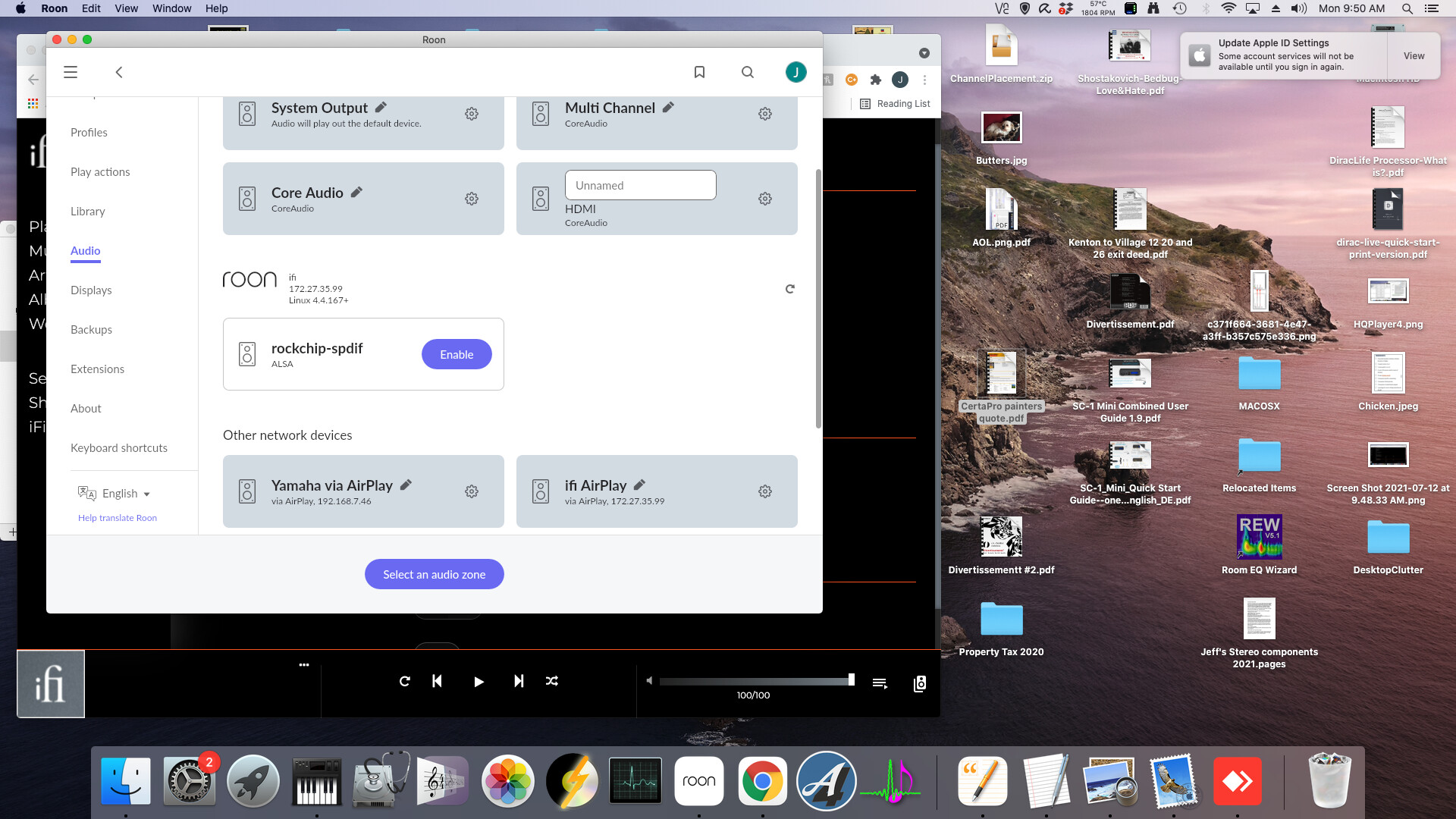

I have a NEW ISSUE. I made the mistake of enabling SPDIF in Output Device settings to compare to USB. Now I am unable to go back to USB. It only allows SPDIF in pulldown. Roon no longer shows other iFi USB zone only SPDIF. I have tried Factory reset to no avail.
Not sure if this will help your current situation, but and I can’t remember which way it is, but I believe if you have USB and Spdif connected one of them counteracts/Disables the other! (this is according to iFi)
As a Roon user I know I can have both connected, but I believe I Did it in the order of USB first Named it, Then Did Spdif, and named it differently, and have verified both can work at the same time with Roon only!
Also I believe you can do a factory reset with not much issue on the ZS, as long as you are not having any power related issues!
Hmmm, it sounds like the USB DAC is not powered on or not connected properly I would try reconnecting it. It may not matter, but use the bottom USB port on the ZEN Stream, make sure the DAC is getting power and that you’ve selected the USB input (if the DAC has multiple inputs, like the NEO iDSD).

So, the ZEN Stream definitely does not disable the USB input when something is connected via S/PDIF. In fact, I don’t believe that the hardware exposes connection state to a downstream DAC via S/PDIF. However, for USB, a DAC must be connected, powered up, and active to make the USB connection visible in Roon.
I did not mean to offend, but since this is a Roon forum, my comments are focused on how to use the device successfully with Roon. There are threads on other forums like head-fi.org and audiosciencereview.com if folks want to learn about non-Roon use cases.
I finally was able to get Roon to see usb, by going from rear selector #1 to #2.
