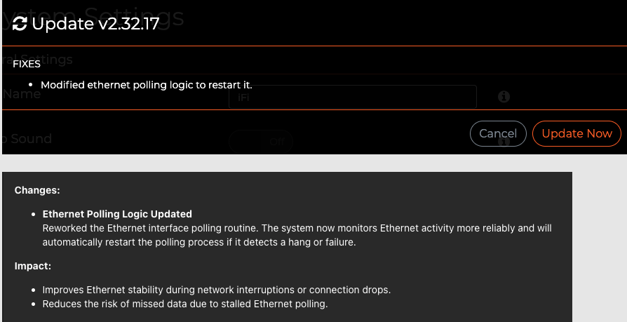

Hi, just to let you know that iFi released a new firmware update today. It went smoothly for me. After the update, it will restart and go back to the default SPDIF output. You need to switch back to USB if that’s what you’re using
This evening, I turned on my zen for the first time in 2 months and because I’d had 2 glasses of wine, I recklessly checked for system updates only to get giddy with excitement to discover that there was a new update !! (2.32.17 released April 9).
With sweaty palms, I clicked “update” and after 10 mins I was shocked to discover that the update had completed successfully and that the Zen was still fully operational !
I’ve also not had any dropouts in the last hour…
How far we have come…
Damn fine device the Zen (for those for whom it works).
This update should be of use for those experiencing dropouts

The back knob has to be in mode 1. Then you update the system via the App. It’s never been a problem for me and the latest one went smoothly.

Hi mate, are you on the latest firmware? Since 2.32.17 FW version, I have zero issues with Zen Stream. I’m using ethernet connection and also manually disabled wifi in settings (there was some wifi automatic enabling issue in previous FW version, causing some instability issues and drop outs for me)…As an alternative (upgrade), I’m considering Gustard X26 iii, DAC with renderer supporting DLNA (so you can use Bubbleupnp for streaming services), Spotify connect and I think it’s also Roon ready..
