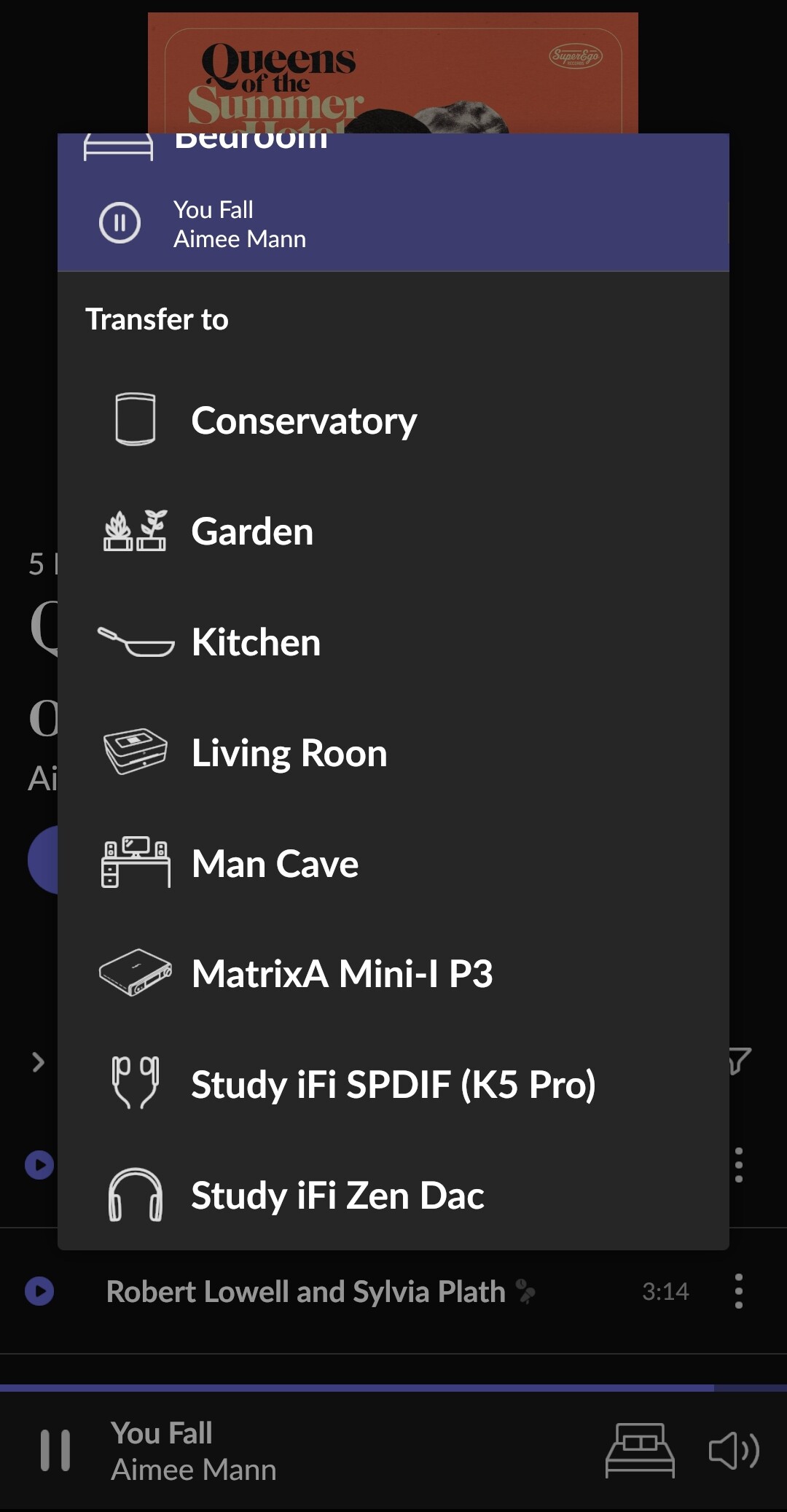

I am assuming that you are not using Roon in that case, as Roon shows both output’s when they are engaged and I often switch between the outputs.
Are you using the web player or something else?
I am using roon. Here is a screenshot:

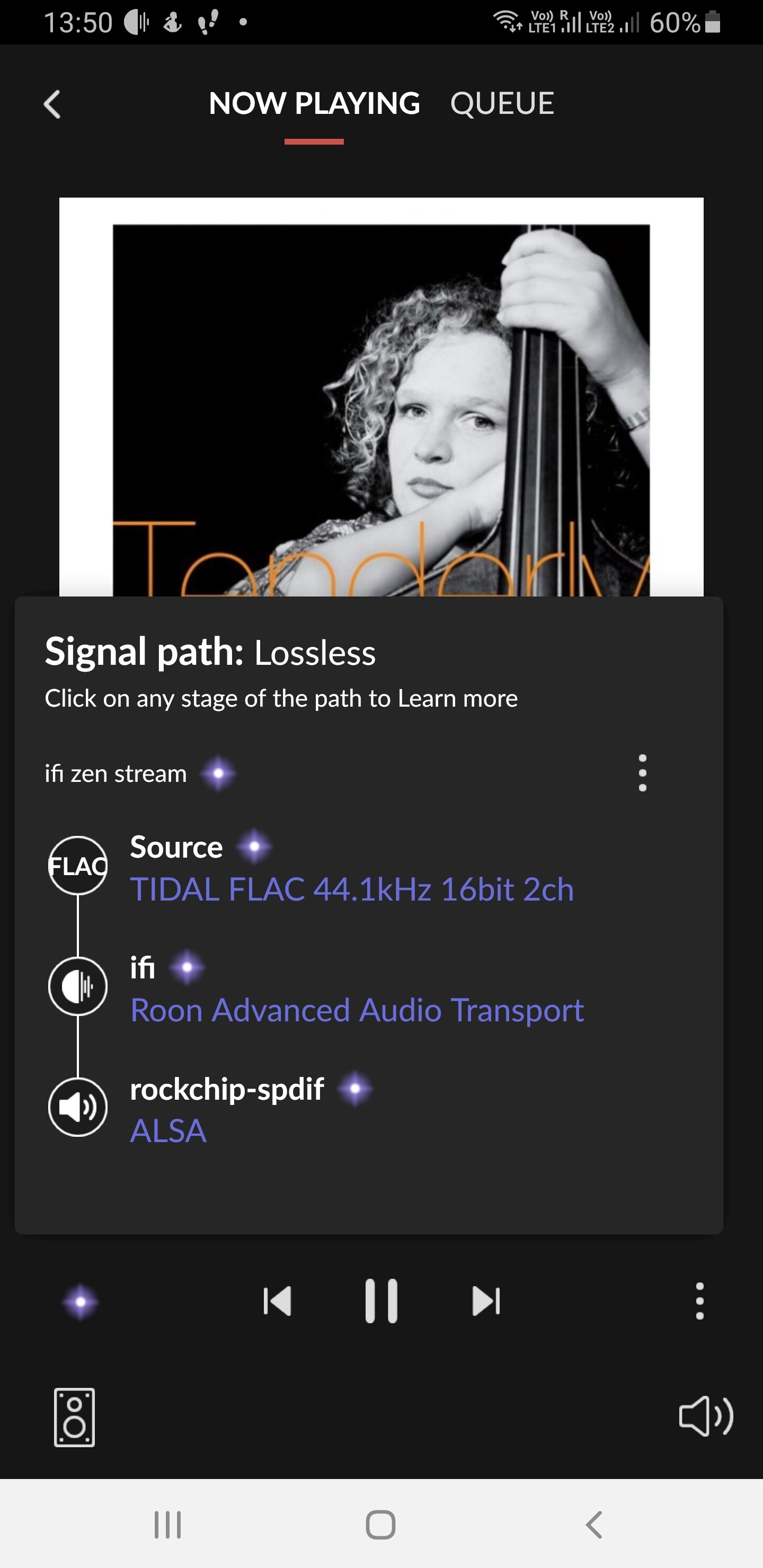

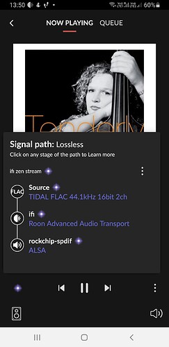

I take it you are both on the late September firmware and if you go into Roon and settings->About that you have the latest Roon Bridge installed (1.8 build 814).
On my Stream which I just turned on and flicked the DAC setting to SPDIF I get this if I transfer a song in Roon. I only go into the web interface about once a month to check for a firmware update.
They both start playing within seconds of me transferring the music.
