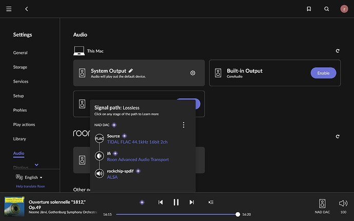

i am trying to play Tidal through Roon tonight. Roon shows my DAC is engaged but no sound from the speakers. no sample rate displayed on the DAC which probably means no SPDIF from the ZS to the DAC? Roon seems to have issues with the IFI, too bad it sounds so good compared to streaming through the Tidal app. maybe i should switch to the exclusive Roon mode from the AIO mode on the IFI. forget about Spotify? there is a work around i have been using. 1. open Spotify 2. select IFI ZS 3. play track in Spotify 4. close Spotify 5. open Roon and select IFI ZS 6. now if i play the track in Roon sound comes out of speakers. can of a hassle.Roon and IFI are strange bedfellows. any ideas? on top of that i looked into my receipt from Roon and found out that double billed me for 4 months.

i have a NAD D1050, i did cycle the inputs on it, opt, usb, coax. still no go, no sample rate displayed on the coax input from the ZS. no sound. coax 2 hooked up to dig. out on OPPO player no problem. i have been using the All In One input on the ZS. i will try it. maybe i will have to buy a USB cable? it will have to be USB 2 on one end for the NAD and USB 3.0 on the other end for the ZS. do you think i will have to buy another DAC that will play well with the ZS?
Hmmm…what are you using for a digital cable to connect the S/PDIF output? Any old RCA cable will not work reliably. It needs to be a 75Ī© digital cable like this:
BJC Coaxial Digital Audio Cable,… https://www.amazon.com/dp/B00287BNKE?ref=ppx_pop_mob_ap_share
Supra Trico coax cable. it’s about $100 1m. the coax in Roon mode 2 worked for a bit with the sample rate showing. now Roon shows track playing and NAD DAC displayed but no sample rate displayed nor sound from DAC?

all i can say is that the Zen Stream has ruined my Roon experience. it will crash even after i selected the Roon mode on the Zen Stream. more specifically the Roon app. shows that the track is still playing (purple light) but no sound. i can see that my DAC is still in the signal chain, but eventually that is gone and i get an message ā€œplease select an audio sourceā€ go back into settings and my DAC is no where to be seen to be selected and start the cycle over again. meanwhile all the lights on the ZS are still on. i took the ZS down to the local NAD dealer to see if it would function there. no way. but the Bluesound 2i worked flawlessly with my NAD DAC. i also had the dealer check all the coax inputs on the NAD. i have done everything Roon has suggested.
i will run down and get a Supra USB cable today. thanks for reminding me. worth a shot for $60, i really want to love this thing. or a Denafrips? would a USB SQ be as good as the Coax? maybe the ZS would partner better with the NAD over USB?
as reported earlier i could not a digital signal from Zen Stream to the DAC even though in Roon showed that everything was working in the chain. track playing, Zen engaged, DAC engaged. what a mystery. all suggestion from the forums did not work but today i stumbled on something. i went into the ifi setup menu and in settings found something called ā€œconfiguration wizardā€ i opened it and selected SPDIF and ran it. now my DAC is receiving the stream from the Zen and the sample rate is showing on the respective coax display and music is playing. and everything is beautiful wow,
