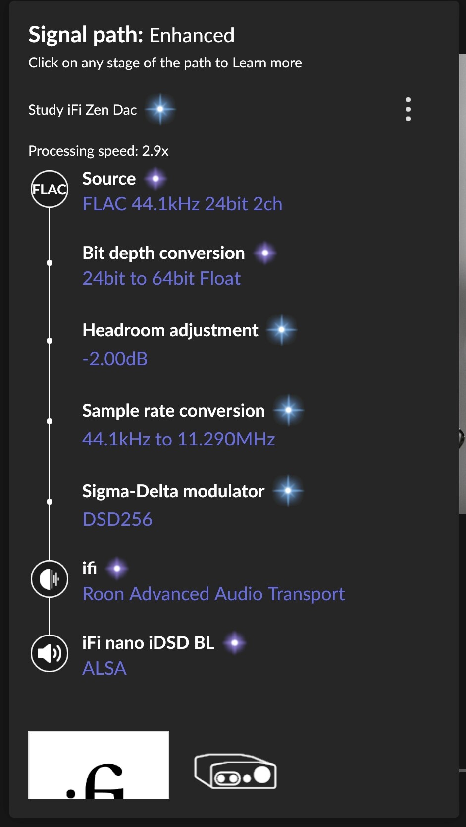

Also go into the devices settings and make sure that it is not topped out at DSD128.
Saying that your Signal path looks wrong. This is how mint looks from 24/44 to DSD128

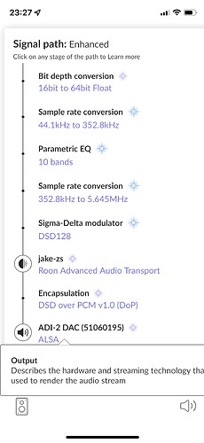

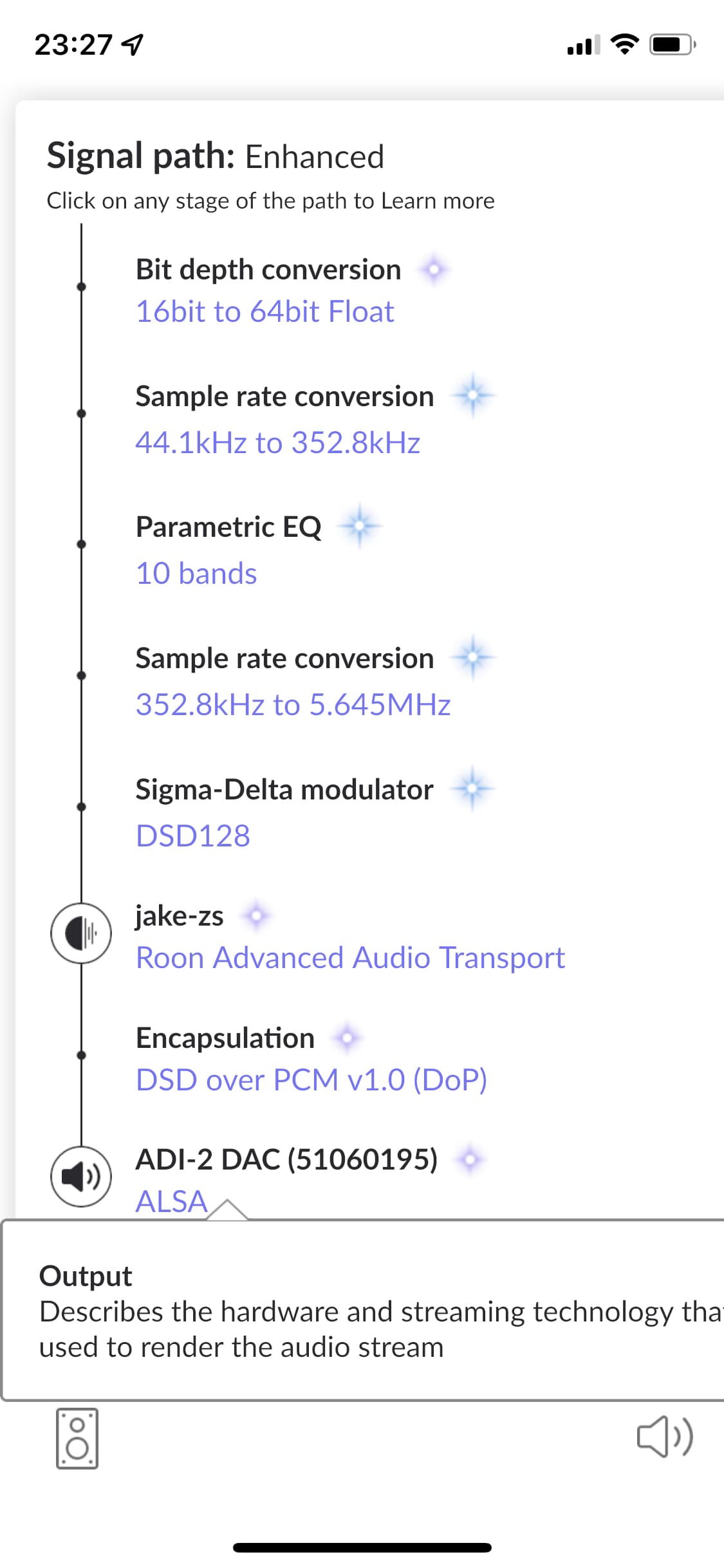

With the ZEN Stream, DSD128 is the max when using DoP. Sadly, the ZEN Stream does not support native DSD for all USB DACs. It may be due to the ancient Linux kernel that iFi have decided to use. It’s over three years old, so many newer USB DACs are not supported.
