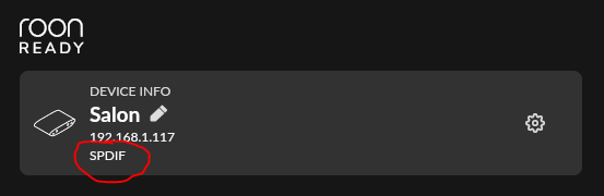

I’ve discovered a new issue with my ZS since upgrading the firmware to the new “Roon Ready” authentication. When I have the ZS set to “All-in-One” or the universal setting on the back, Roon recognizes it and populates the correct settings in the Audio setup—max PCM of 384, 32 bit, DSD 512 (although technically it can’t process higher than DSD 256). However, when I switch to the “Roon Exclusive” mode on the back, suddenly the maximum PCM is 192 and 24 bit.
I’ve attempted to submit an ticket to iFi, but their Wordpress website has a bug currently that won’t allow me to open one. Has anyone else experienced the above behavior since installing the latest firmware on the ZS?
Steven I only see that on SPDIF output, but I am using AIO mode.
I think that Roon only mode makes it so you cannot run the app or change output which I have been doing regularly.
Even though this firmware is Roon Ready, it is still beta firmware. Hopefully that will be fixed in a future update
What output do you see in Roon-only mode in the Settings-Audio section:
I’d guess that in that mode you cannot change the output and as SPDIF is the default one, you are presented with Coax max capacity (PCM 192).
Yes that seems to be what I saw as well.
One of the things for Roon Ready should be that you can change devices from it, so maybe that will come in an update

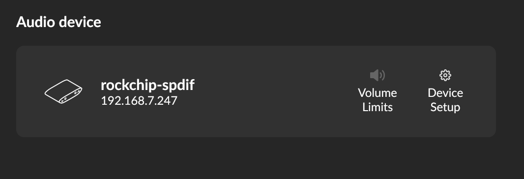

I see something called “rockchip-spdif.”
which is an odd name.
Hi Woodford
Have you updated to the Stream to the Beta build that is fully Roon Ready.
I used to see rockchip-spdif in the past, as I think that is the old name where both outputs could be independently active. Now it seems to only be either or selected from the App/Web page.
