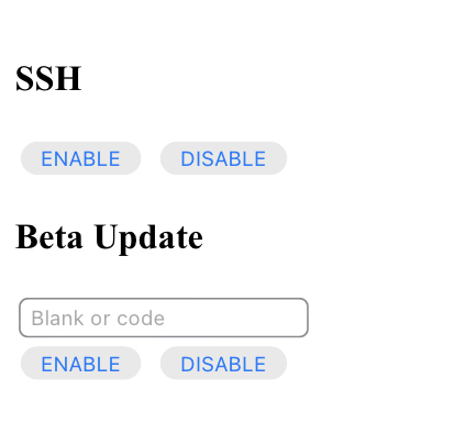

Yes Joel just use if.local/dev
Enable the beta update and then go back and check for new firmware.
It will update to the Roon Ready version

How do I enable the beta update.

To enable the update go here http://ifi.local/dev/
iFi Streamer Test Player
Enable this link and then go to
http://ifi.local/plugin/system_controller-system
And select check updates

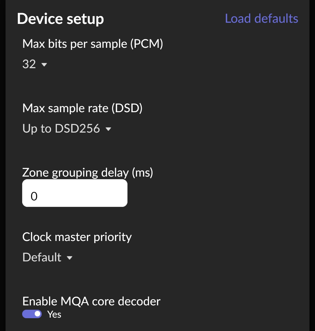

For my Zen DAC via USB I have the following:
And Advanced settings as below
