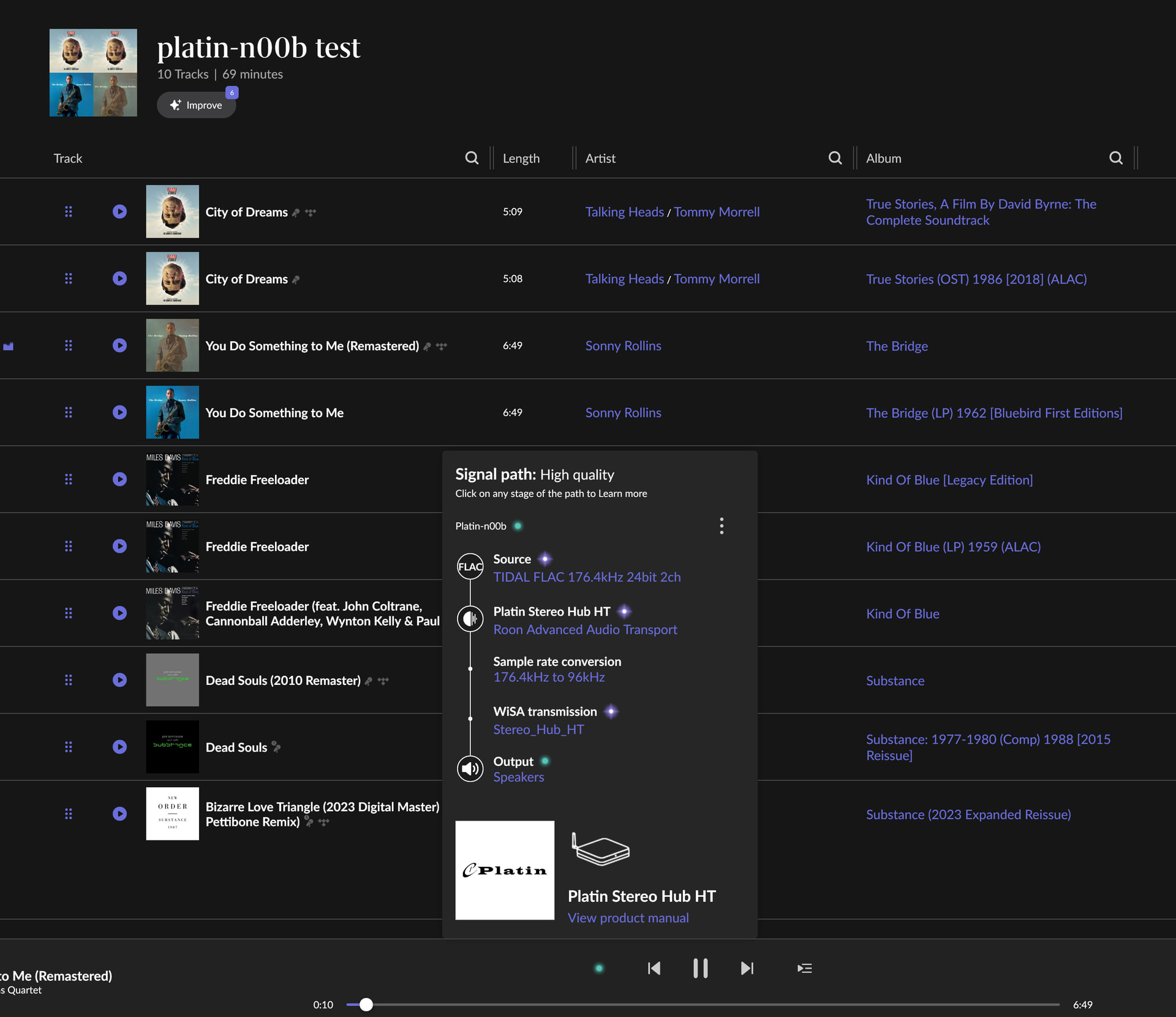

Time Stutter Error

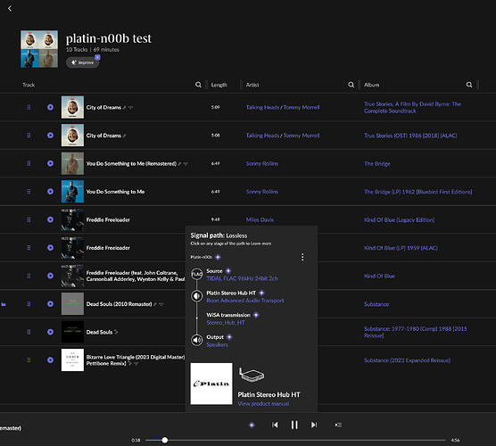

96kHz Native content Time Stutter – Poul + Team Platin confirms this is fixed in the upcoming Firmware.
Signal Path Error

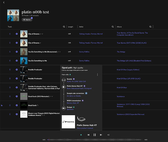

ROON Signal Path should correctly read “Lossless” or “Enhanced” instead of “High Quality”
There is some RAAT mis-communication for non-96kHz-native content that is converted to 48kHz that reads as “High Quality” instead of “Lossless”. If you employ Room Correction, the Signal should read “Enhanced”
Right now with new Platin Hub HT the ROON path reads “High Quality” which might be a visual handshake error and the audio coming out of the speakers is “Lossless/Enhanced” IRL.
Let’s hope this is also fixed in the new Firmware.
