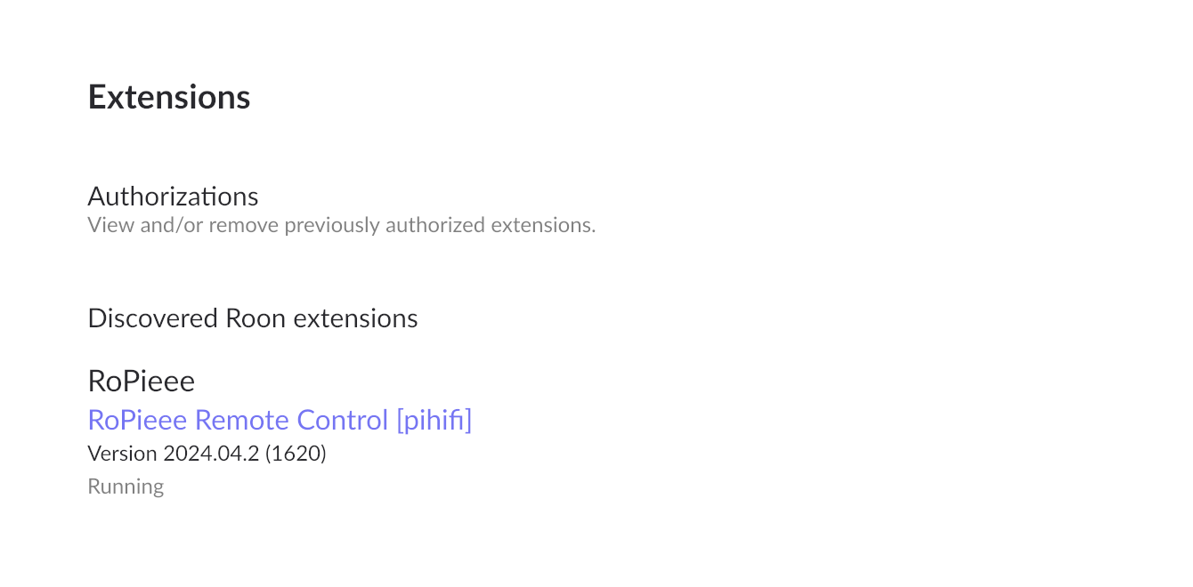

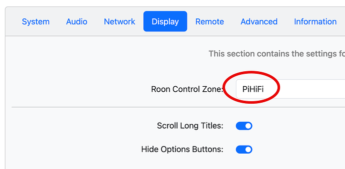

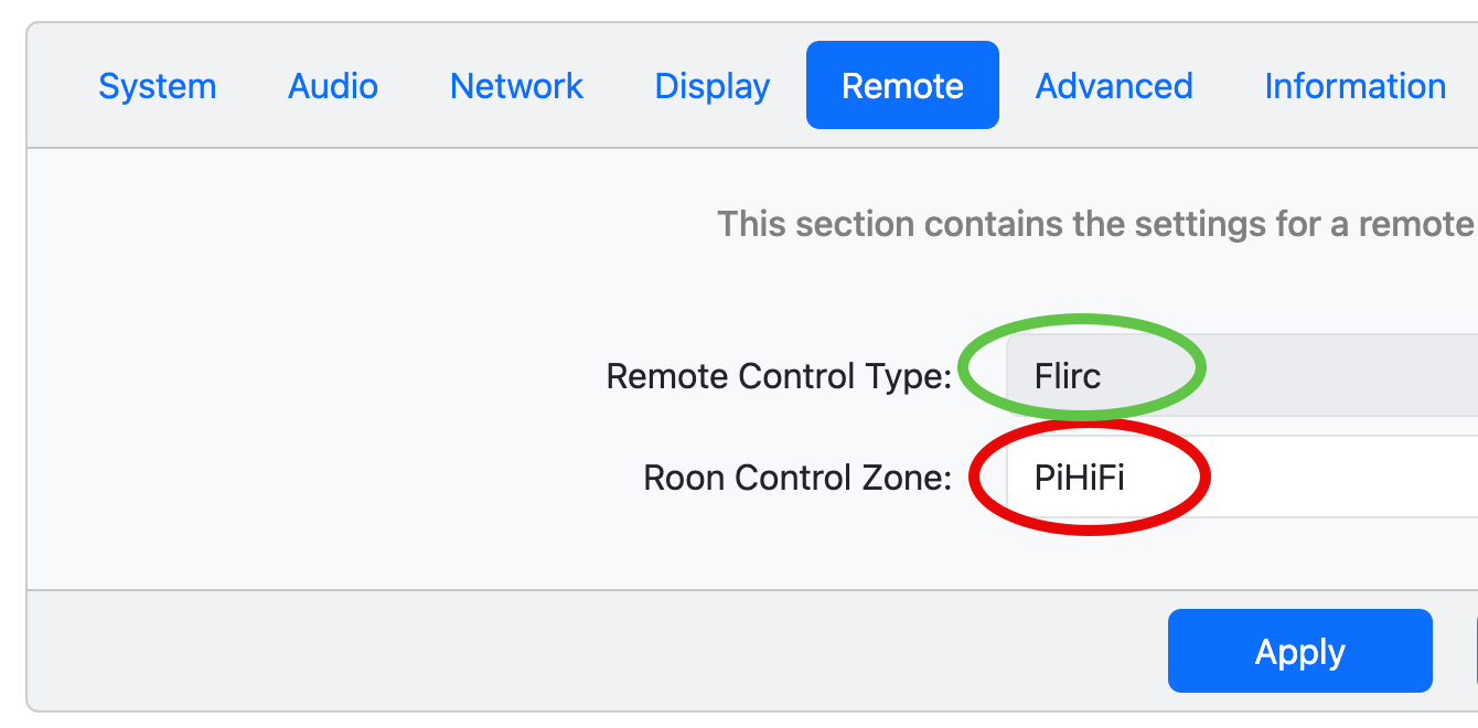

Zone is definitely set up properly because the display works fine and the functions available on it (play/pause, prev, next) also work properly. I have very same zone name (“PiHiFi”) for Display and Remote (in Ropieee) and in Roon audio settings. The Ropieee Remote Control extension is enabled in Roon.

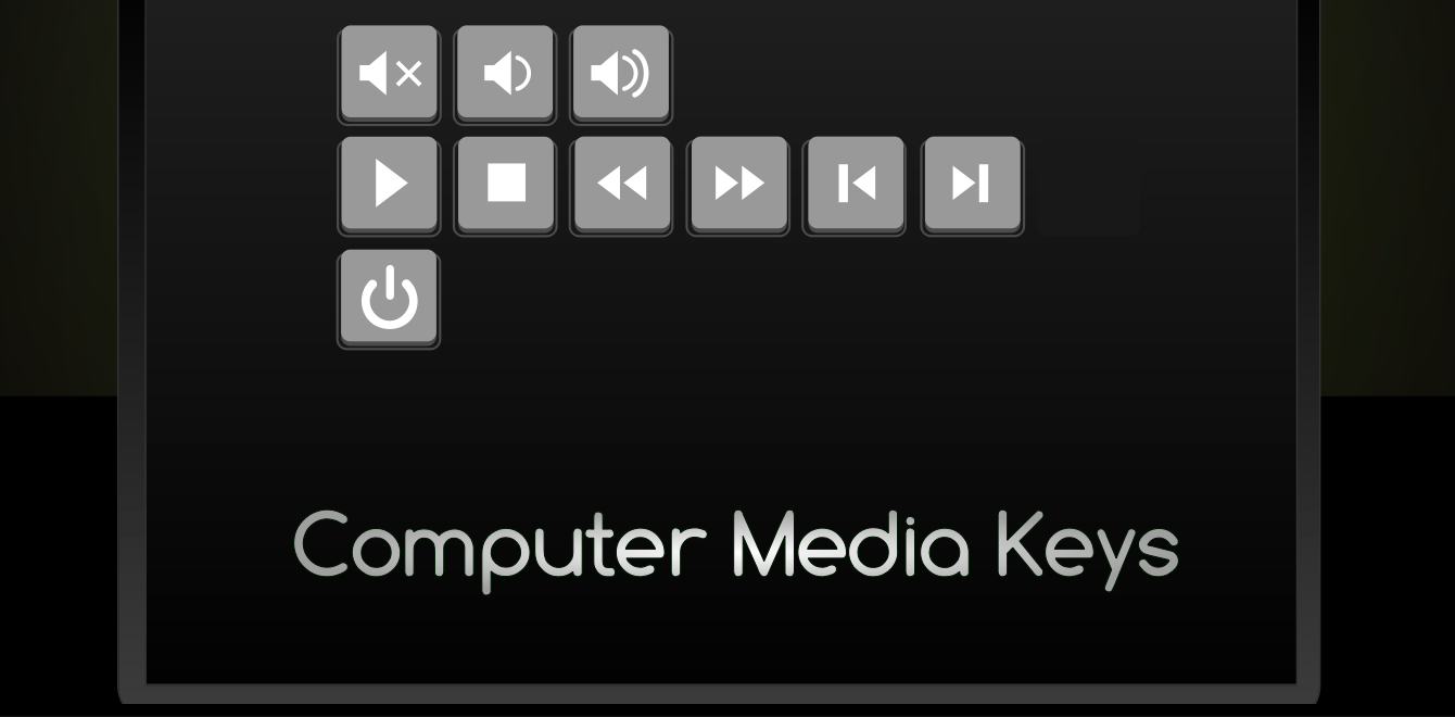

The Flirc receiver certainly works properly and is configured properly - when connected to other devices (PC, macBook) it passes right keystrokes to the system. According to the instructions (page 38), I even set up just simple “Media Keys” (which doesn’t really matter - Flirt acts like a keyboard after all).

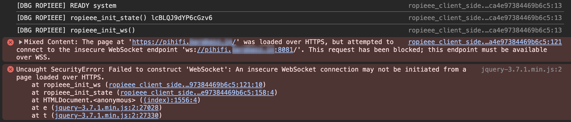

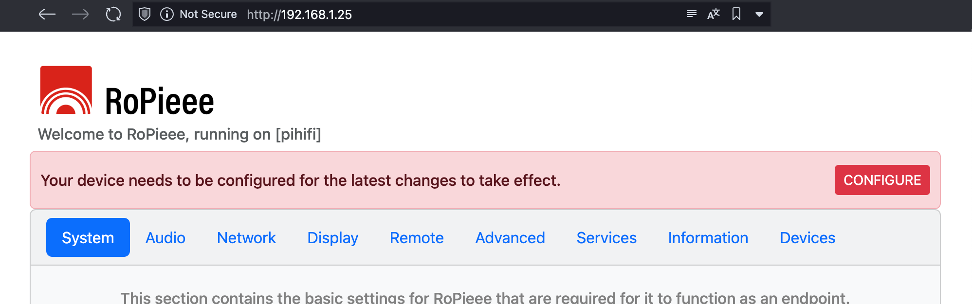

Eventually I ended up with Ropieee installation from scratch using newest image (2024.9.1 stable 20240928.1802). Also no luck but… I finally understood what was causing the whole problem: I couldn’t save the configuration in Ropieee because I didn’t see a banner with this information (I thought just clicking “Apply” was enough).
This is the culprit of all the confusion: the Ropieee’s web interface and more specifically this element: div.containercontainer.alertContainer
I barely use IP addresses in my LAN - I’m always using domain names and reverse proxy. And, in my opinion, Ropieee incorrectly fetches data to this element using WebSocket asynchronously.
This is what I see using HTTPS / domain name:
And this is proper view using HTTP / IP:
Here is console error:
I “blame” Ropieee’s interface because I’m using dozens of much more sophisticated services this way (like Synology web apps, Ubiquiti Unify, Proxmox, HomeAssistance, etc.) - and everything is working perfectly fine. I’m using Nginx Proxy Manager as a reverse proxy with “Websockets Support” option enabled.

To cut long story short: after reconfiguration (which I was able to run using IP) and reboot - Flirc is working in Ropieee as it should. Thank you @spockfish for this amazing piece of software.
Reverse proxy support will be fixed in the next release.
