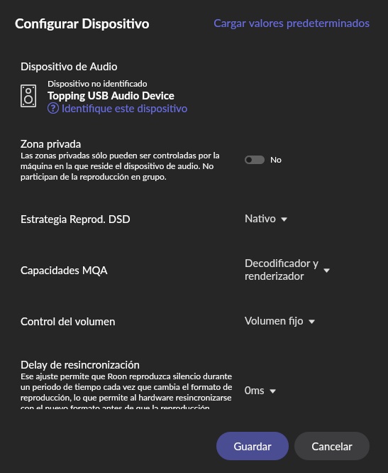

The option used to be displayed here on the device configuration pop-up

Sorry for the delay, @macaumetal and thank you for providing this screenshot. This is indeed strange that the exclusive mode is not present in the device setup. Are you using ASIO or WASAPI drivers with this device?

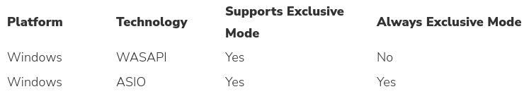

Are you sure there ever was that option shown at all for ASIO?
Roon usually does not show pointless options and according to the guide “Exclusive Mode”, exclusive mode is always on for ASIO (so showing an option to control “Exclusive Mode” would be pointless).
Why? Do you need the option to turn off “Exclusive Mode” offered by WASAPI drivers? If so then yes you have to change then. If all you want is to have “Exclusive Mode” (turned on), then just keep using ASIO if you want to and stop worrying.
