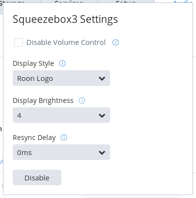

Your settings look like this, right?
My settings do look like the screen cap above.
I’m using the analog output to an aux input on a Cronus Magnum (if that matters in anyway).
