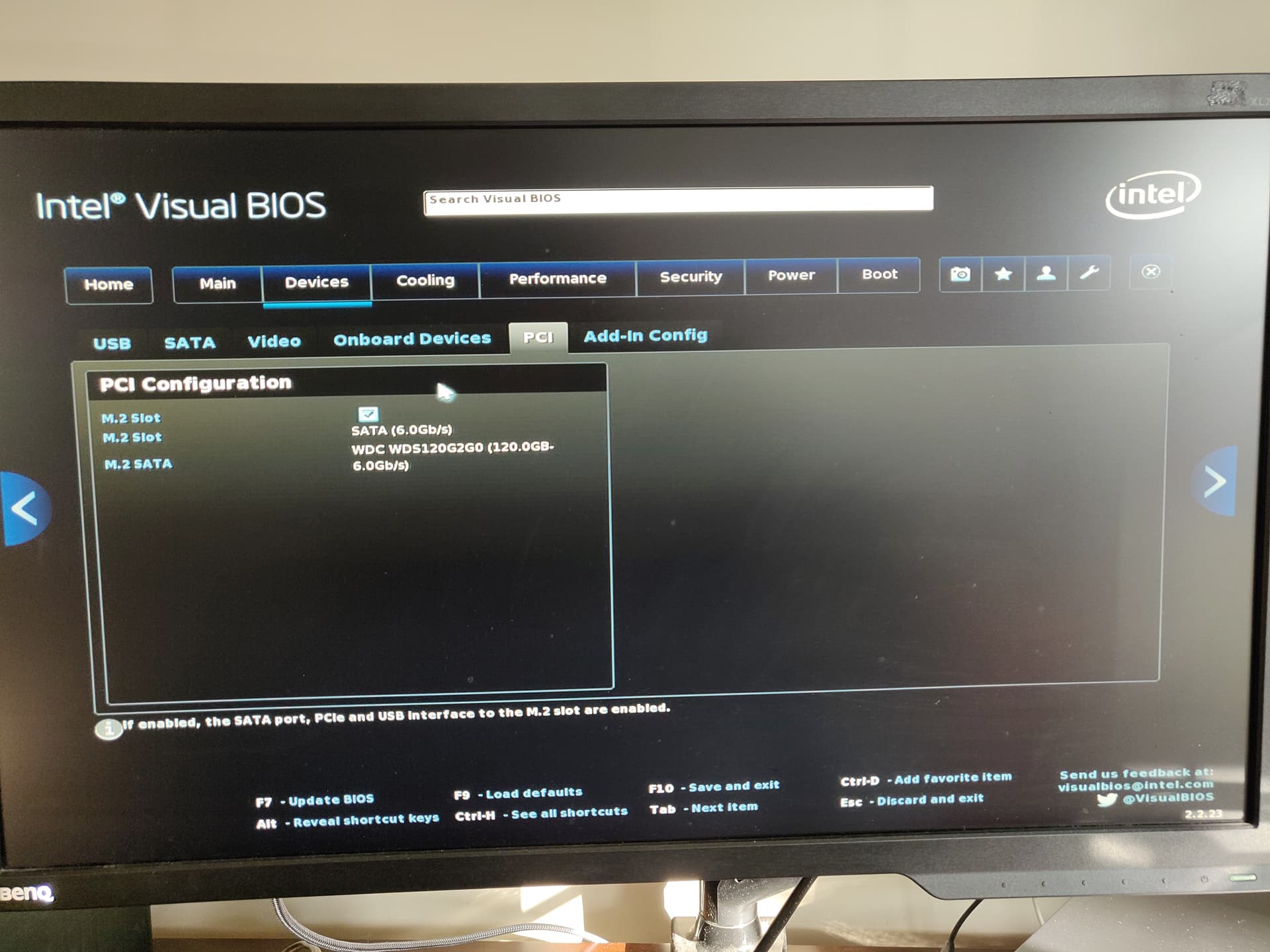

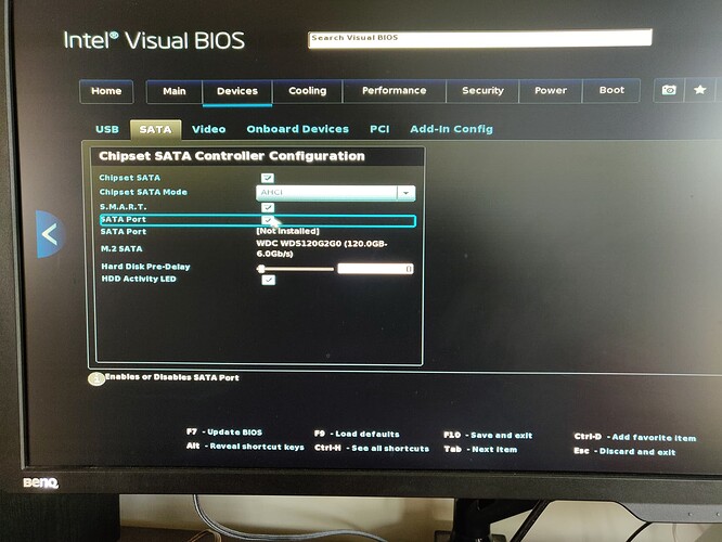

Again I get to the “Roon install is completed” but after that I am unable to get to it. I included the screenshot of my bios settings.
Any help will be much appreciated.

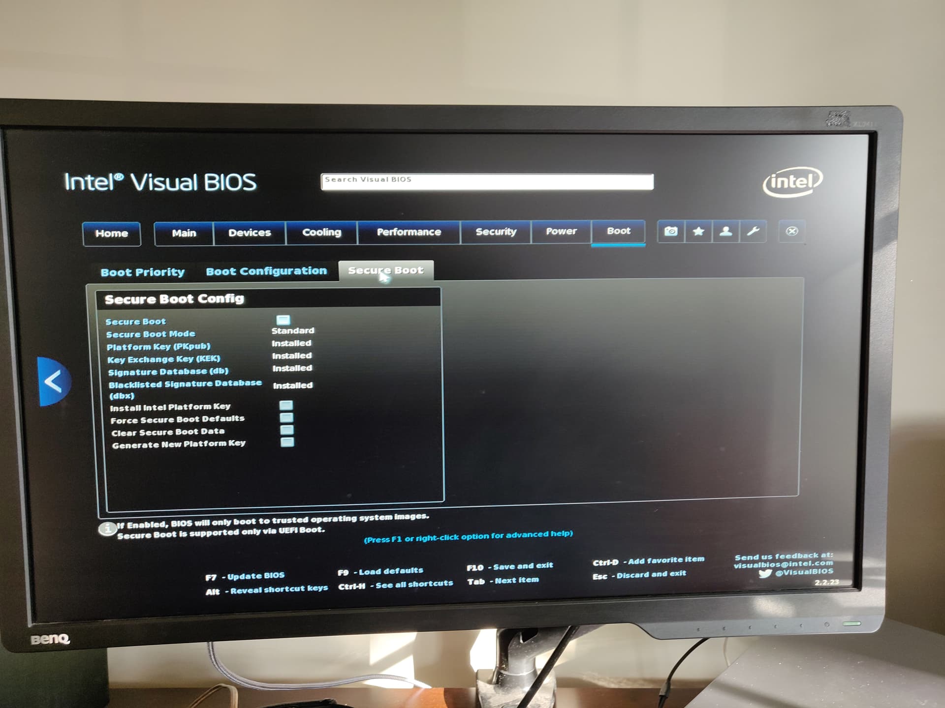

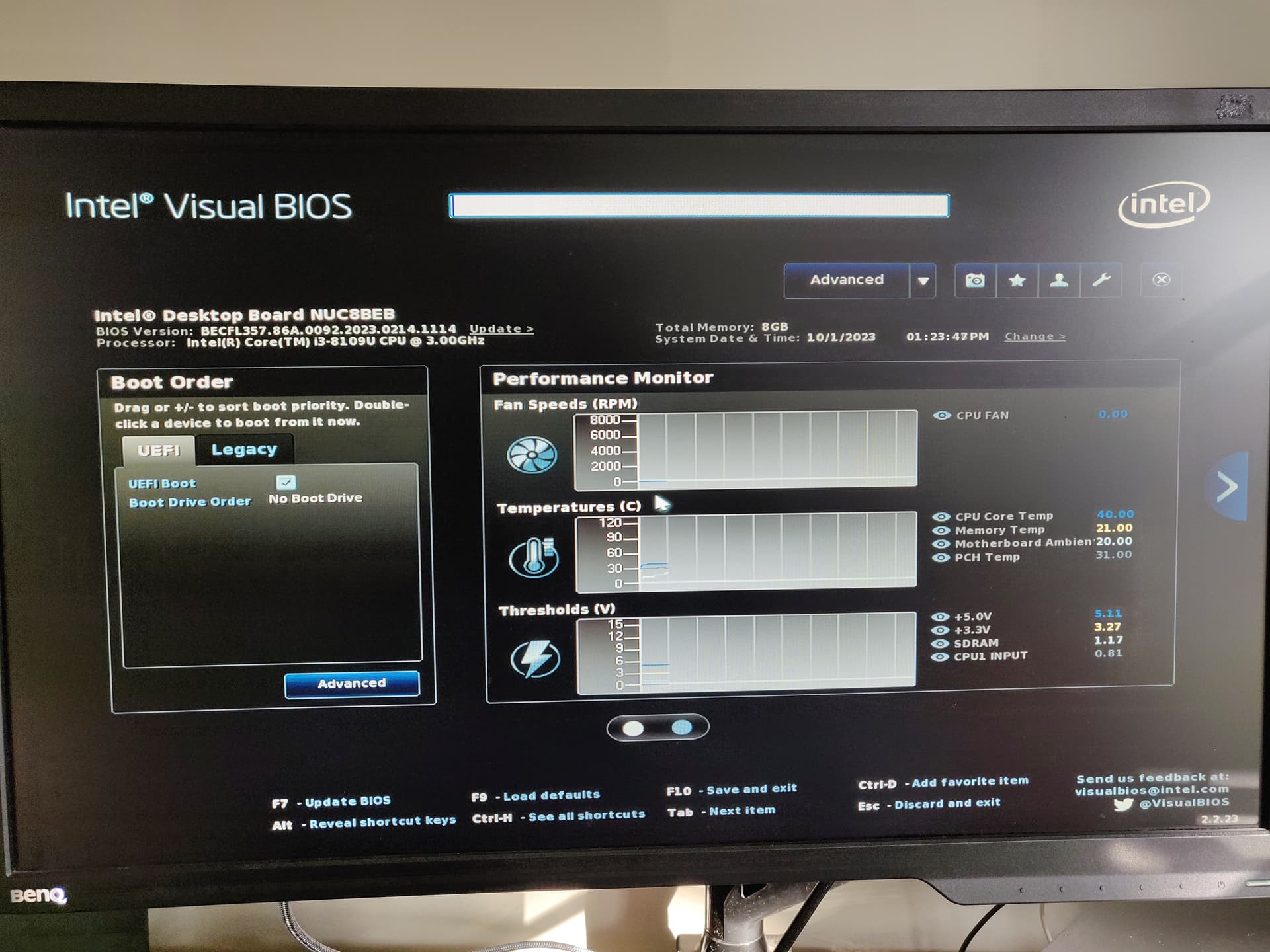

Current ROCK requires UEFI but as far as I can tell it is set to Legacy (BIOS) boot. It says “No boot drive” on the UEFI tab in your 3rd screenshot, and instead the SATA boot drive is listed on the Legacy tab in the 4th screenshot. Same on the 5th screenshot, no boot drive on the left (UEFI) but instead on the right (Legacy). In the 6th screenshot, it doesn’t look like you turned off Secure Boot either.

Secure boot is disabled and UEFI is enabled in boot priority it just does not list any drives there…
FYI I have tried every combination of these possible other threads in forum suggested using legacy and then installing from there still no luck…
OK, but as long as you don’t have a drive in the UEFI boot priority it can’t UEFI-boot from it. Not sure why it is not there though.

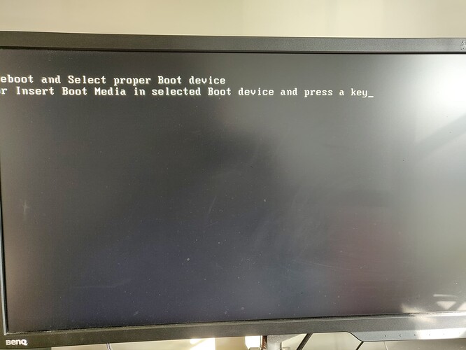

Yea I think that is main issue, never seeing the drive when in UEFI. If I turn off Legacy and redo the whole install with UEFI only, it shows No Bootable Device and the M2 is not listed ever in boot priority. Again every time the roon install show succesfull :person_shrugging: Wondering if updating my Bios messed up something…
Here’s what I see after doing the above in Bios

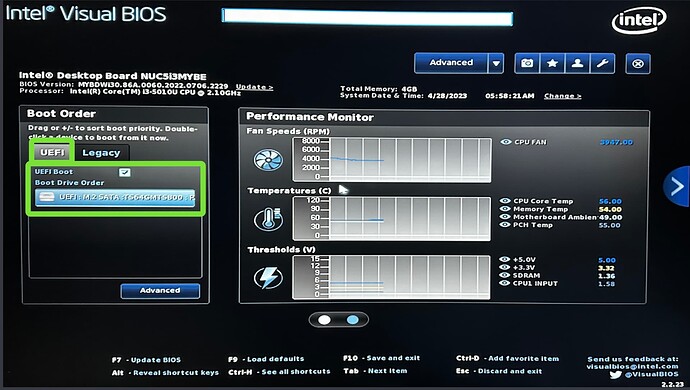

Welp I finally fixed my issue and I’m very pleased. If this would not have worked I would have probably given up… I guess my installation is sort of an edge case? The installation guide doesn’t cover this at all but if you have a used NUC with a previous install (possibly in legacy and UEFI) additional steps need to be taken.
If someone ever stumbles on this thread I did the following:
  1. Follow all the Bios steps in Roon install guide (except you won’t see your SSD in boot priority of UEFI) Also turn off legacy to be sure.
  2. Before flashing Roon Rock install do the following:
  3. Download Windows 10 Installation and flash it to your USB. (you could probably use another software but I wanted to use Diskpart).
  4. Boot on the USB
    5 Go to repair and advanced and command line (you can look for other tutorials for that)
  5. Using diskpart chose your SSD and use clean
  6. For good measure convert it to GPT but mine was already listed as such.
  7. What hapenned for me in this case was that the disk switch from free 0 to the whole disk free.
  8. I then proceeded with flashing Roon and was finally able to boot on it.
Included screenshot with steps I took with before & after. Really hope this helps someone one day!
