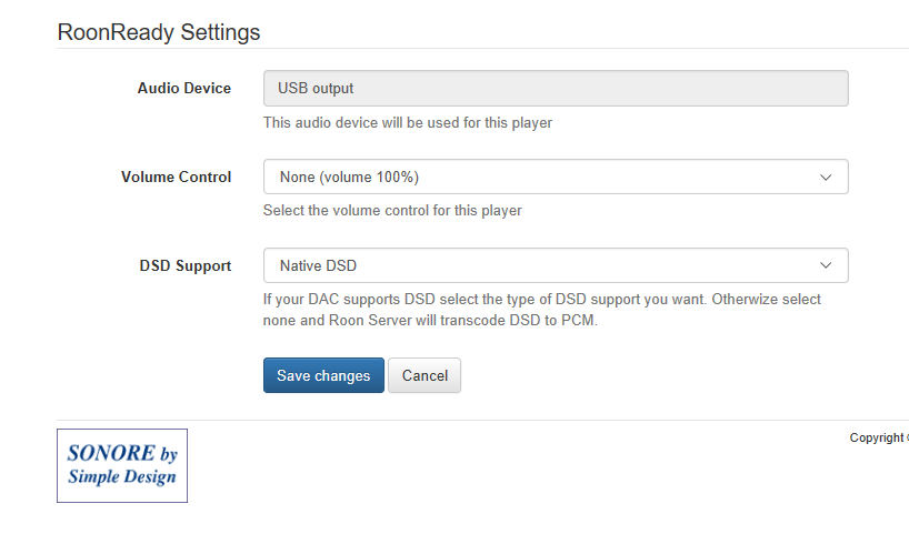

I have been trying some DSD files via Roon to microRendu, to Mutec MC3+USB. They play ok, but Roon is performing DSD to PCM conversion
The microRendu’s settings are as follows:
OK, not a big deal, music plays, but I presume I would get better results sending DSD to the mR/Mutec, rather than performing the conversion in the PC via Roon. Is there any reason why Roon is converting rather than sending DSD to the mR?

Are you sure the MicroRendu supports Native DSD to that DAC? I don’t see it on their list.
If it doesn’t, you should be able to avoid conversion to PCM by using DoP. Let us know how it goes!
Thanks Mike, it looks like you are absolutely correct. I’ll be honest, I’m new to trying the world of DSD, other than good old fashioned SACD’s in a disk player. I think I’d just made a newbie’s mistake, I’d read that both the mR and Mutec could deal with native DSD, but missed the subtly of the mR not supporting native DSD to the Mutec. Anyway, at least I’m on the learning curve now.
