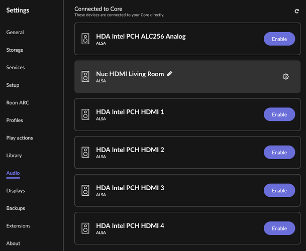

It is possible with a NUC and I do this, though there are some missing drivers (or issues for the latest NUC 11 & 12 models).
For my NUC10 I see the following after re-installing Rock with the latest release.
This works perfectly into my LG C2 TV and then onto my Sonos ARC, hopefully it will work for you as well.

I needed to configure the HDMI 0 device and it worked, although I can only listen to multichannel DSD files if I configure it to convert them to PCM (they are not heard if I activate DoP) although the Marantz SR 7015 is supposed to be able to work with DSD files according to its instructions if I’m not mistaken…
On the other hand, in the Roon panel of devices connected to the NUC, there are 4 more HDMI devices when there is only one physically (as seen in your screenshot), do you know why this is?

It is supposed to mean different output types (e.g. 5.1, 7.1) but I haven’t gotten any to work nor do I have a lot of multichannel content. The stuff I do have I have on SACD or Atmos via AppleTV so I don’t really need it on Roon.
D&M does NOT support DoP. I’ve lobbied for years - they won’t touch it.
These are internal HDMI channels. The only relevant one to use is the HDA Intel PCH HDMI 0 device.
