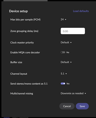

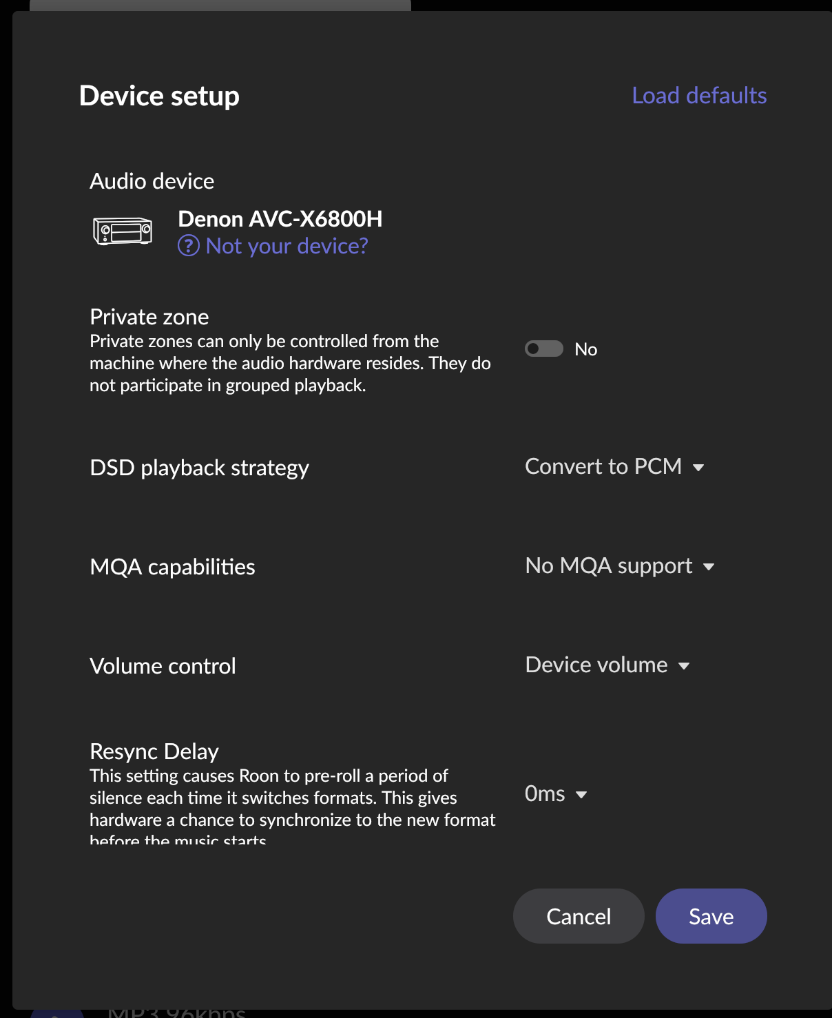

It should work but as Matt advised in his nicely detailed response it could depend on the AVR. It works well with Denon and I’ve used it for many years.
When using the HDMI zone if the issue occurs check the signal path and post a screen shot here. Perhaps that will give us an idea of what is happening.
