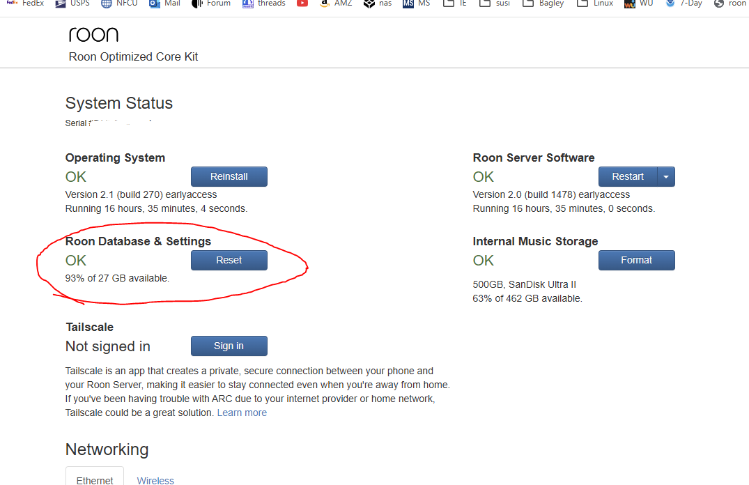

I also wonder if you did a fresh install of ROCK, or at least a DB “reset” and then an OS reinstall from the webui then re-import of all music, if the search might speed up?

I’m not sure what you mean by “DB reset”, if it means reloading all library and reset the time stamp of added dates, no thanks.

this:
Then you could, restore from a DB backup?
