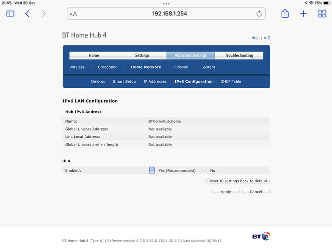

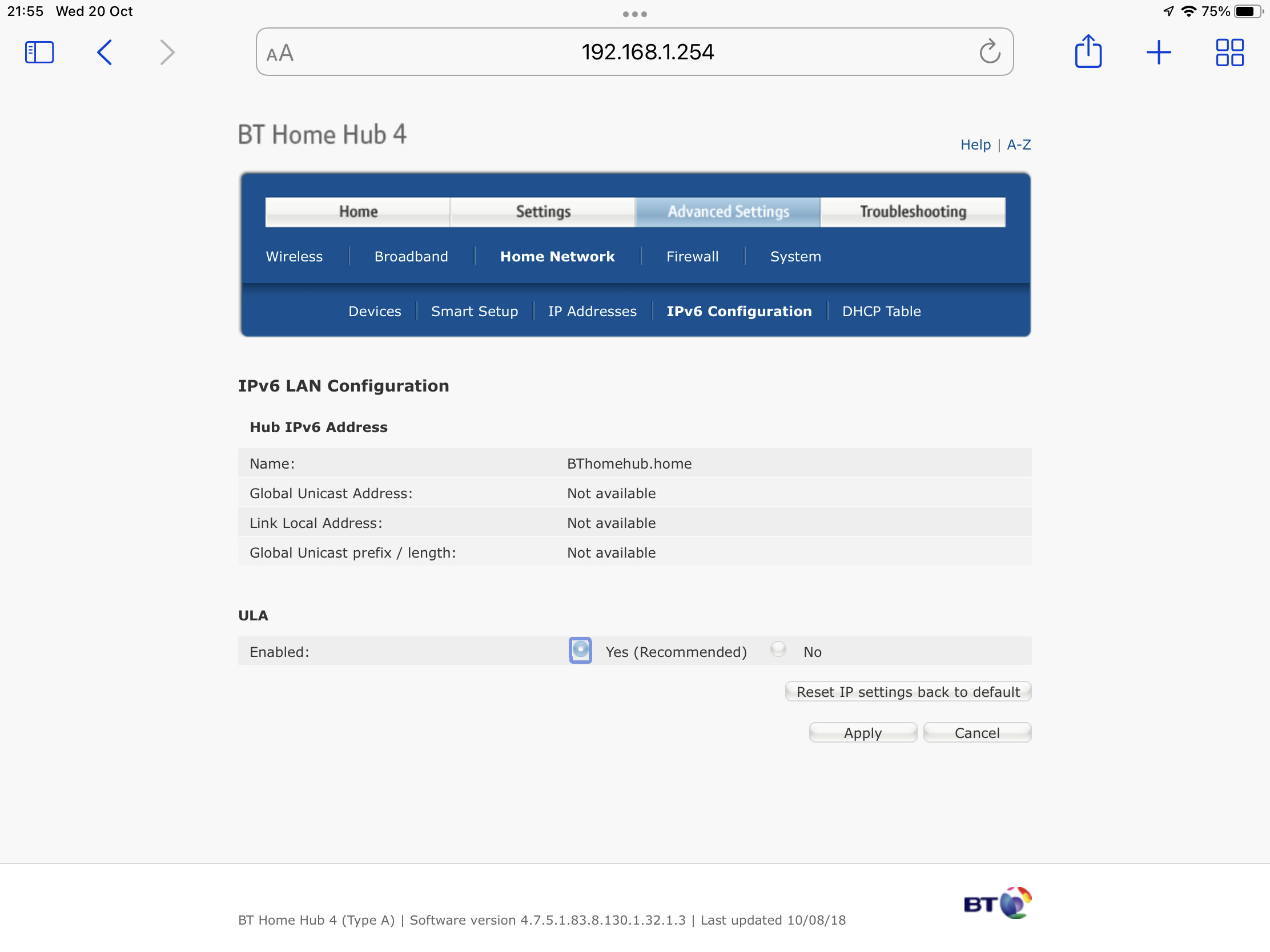

Hi @DJM & @Hector, Another thing that might be worth trying if you haven’t already — If you have the option to disable IPv6 on your network does that help at all?
I think IPv6 support was introduced with BT’s Smart Hubs. I don’t think it was available on the Home Hubs.
Is this it Dave?
Yes, I think so.
I was sure that I read that the HH4 didn’t do IPv6, but it looks like it can. To see if it makes a difference you’ll need to turn it off, maybe reboot the hub, then reconnect the nucleus to the hub. Keep us posted.
This was the source that lead me to believe the HH4 couldn’t do IPv6.
Hi Dave and @dylan
I disabled IPv6 on the HH4, and Rebooted it. 15 minutes later, almost to the second, HH4 Reboots and loses connection with the Nucleus.
Clearly that didn’t work. Should I enable IPv6? Things did appear to slow up a bit, within the HH4 manager.
