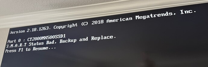

Let’s start by confirming that the Nucleus is booting correctly. Please connect it to your TV via HDMI and take a photo of what appears on the screen.
Next, connect a keyboard to one of the Nucleus USB ports and type the command:
resetnetwork
After that, reconnect the Nucleus to your network — ideally while still connected to the TV — and check what is displayed in the EREOS application.

Hi and thanks for waiting for me had issues all good now. So I hooked it up to TV and got this message, see photo. Looks like the Nucleus is cooked? Thanks again
well just looked it up guess its the internal ssd is failing most likely? I ordered a Nucleus One last night cuz I figured this was bad oh well hopefully can sell this one but will wait to see what you guys say thanks again @vadim @connor
Thanks for the update @james_cortez!
You are correct in that, based on the screenshot you’ve shared, the m.2 SSD is failing and needs to be replaced.
I’ve already pinged our Nucleus Team (who has your RMA ticket in their queue) and updated them with your findings. They’ll follow up with you for next steps and your options with your machine. :+1:
