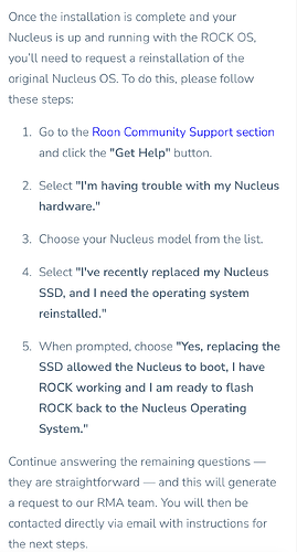

Hi @Robert_Bolender,
This sounds like you have manually installed ROCK on a Nucleus One, if this is the case it will lead to issues as RoonOS that is supplied as part of ROCK does not contain the thermal management control that the original Nucleus RoonOS supports.
I recommend creating a Roon support ticket (there’s an option for this scenario) to get that resolved ASAP before any damage to the hardware takes place.
By the way this is now detailed in the docs:

It does have a fan, and indeed it’s a bit unclear if it needs the Nucleus software conversion. But as it’s just 5 clicks to request it, why not.
It’s a good point, but I’d err on the side a caution, wouldn’t wont to risk invalidating the guarantee or be in a grey area with Roon support.

I looked around for the software to reinstall from a USB for Nucleus One and there didn’t seem to be any on offer. Luckily I haven’t utilized it much aside from initial testing as I’ve been on vacation. Is there a link to the software for Nucleus One online or is support the only option? Let me know. Thanks
Only support can update RoonOS from ROCK to Nucleus. The installation files are not publicly available.

I’ve done so. Thanks

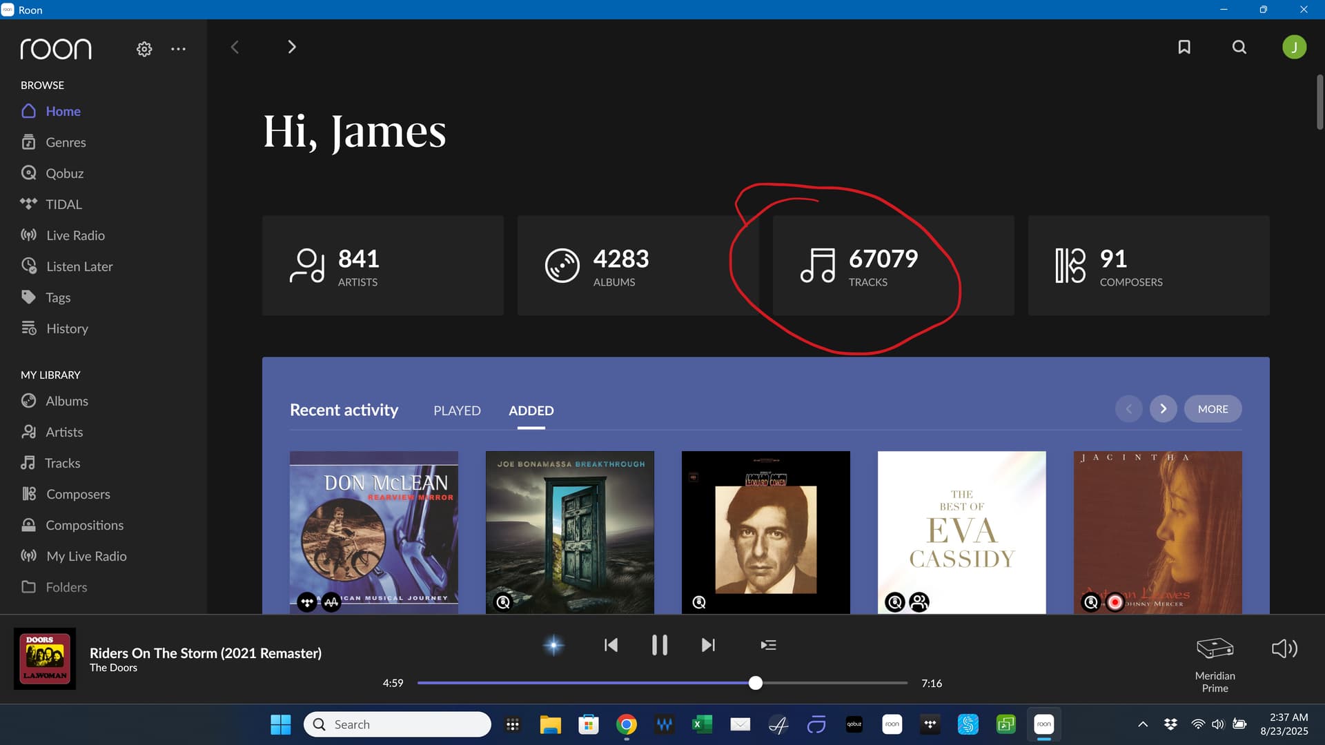

I’m curious. What circumstances suggest it is time to upgrade RAM? Would it be the number of music albums, or the number of tracks? If so what number would suggest that it’s time to upgrade RAM? For example I have 1600 albums.
How many tracks?
I only have albums.
On a Nucleus or ROCK? If it crashes.
Roon OS does not work slower if it’s out of RAM. The symptom of being out of RAM on Roon OS are crashes. If it doesn’t crash, more RAM does not make it faster or have any other effect.
I can dig out the many posts by Roon’s Danny confirming this, but I’d rather you search yourself or believe me :slight_smile:
Edit: I did it anyway. See the links at the bottom*.
Albums consist of tracks and it’s the latter count that really matters.
Pop/rock albums contain ~13 tracks on average, so with 1,600 albums you might have 20,000 tracks.
A Nucleus or Nucleus One with default RAM is rated for 100,000 tracks.
* The links. Danny is the guy who built Roon OS.
