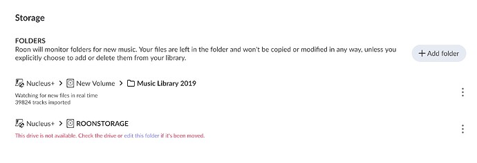

Thanks for writing in to let us know about this issue. As a first troubleshooting step can you share a screenshot of your storage settings?
Hi Daniel,
Thanks for getting back. The first part of the image below is the original message after the update with no sign of the original drive . The New Volume drive mentioned below that is where I have started re-populating a replacement external WD 5tb drive . The original had 66k tracks so I have a long way to go yet.
I have not been able to read the original SSD or get any of the music off it unfortunately.

The original drive is also attached but not appearing in the list . Add Folder doesn’t see it as an option or on the network . Only the newer 'Baby Backup ’ drive is available .

Hi , ROONSTORAGE only ever had Music on it . It is still attached but not seen by Nucleus+ . Newer external drive is Music Library 2019 as here trying to rebuild collection :

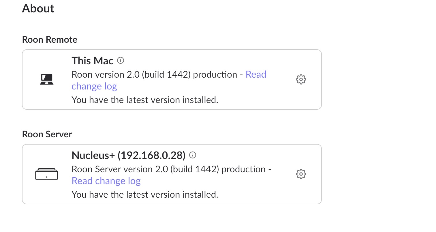

You have established that the external drive has failed, and you have posted a screenshot of your Nucleus’s Web Administration Interface page, which, as far as I can see, indicates that the Nucleus is running correctly.
You seem to have had a run of very bad luck, but I don’t think that the issues have anything to do with Roon updates; otherwise the forum would be flooded with similar complaints.
