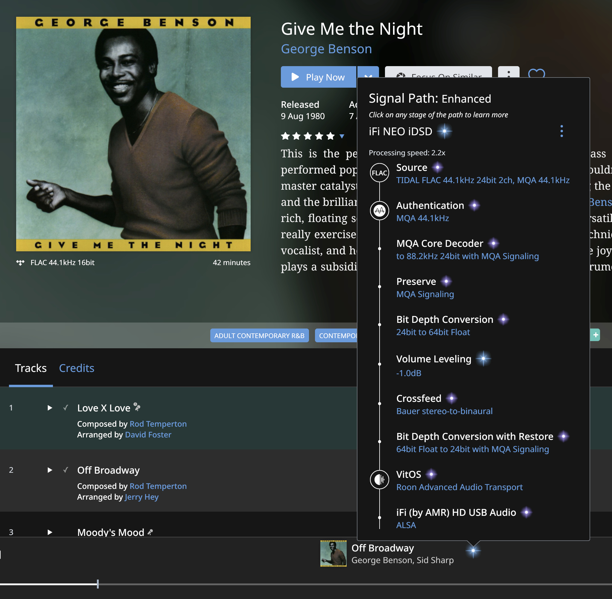

I am actually impressed that it can run Roon Server and play to one zone with just volume leveling and MQA Core Decoding enabled. Here it is, chugging along at 2.2x. Now, to be fair, I do have a (throttled) library update (11 tracks) running in the background…that should finish by this evening. :slight_smile:
I have not attempted DSD upsampling via this Core…I’d be surprised if it can play DSD64 files period, much less upsample from PCM to DSD. Good luck!
Edit: Verified. I can only play DSD files from this Netbook core if I disable volume leveling and all DSP. Fortunately, with this particular DAC, DSD sounds fine this way.
