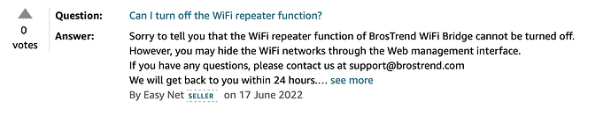

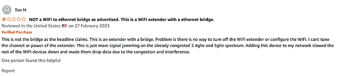

Actually it looks like the “BrosTrend AC1200 WiFi to Ethernet Adapter” is actually a 'WiFI Range Extender” under the hood and that you can’t even turn off the WiFi radio / repeater function :confused:
Which could be problematic as you don’t want your regular devices (like your phone or laptop) connecting wirelessly to the extender.
So maybe better to go with something like this Netgear which does allow you to turn of the WiFi radios (page 23 - Disable or Enable the WiFi Radios).

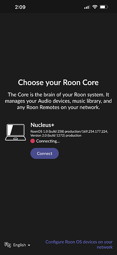

Hello.
I changed the mode of my Asus router (RT-AX88U) to media bridge and upon reboot the Roon remote did find the Nucleus core.
It would not connect unfortunately or allow me to select connect. It eventually loses the core and goes back to searching indefinitely.
Any thoughts on how I can fix this issue? I have not tried the extender because I thought my router would serve the same purpose.
I would check the subnet (192.254.177.xxx) of the Nucleus+ and make sure it is the same as the other devices on the network. Make sure the asus is not serving up a separate DHCP IP range (might need to manually assign IPS?).
You may need to reset the network settings on the Nucleus+ if it had a static IP or it has not “renewed” it’s IP in the new network?
