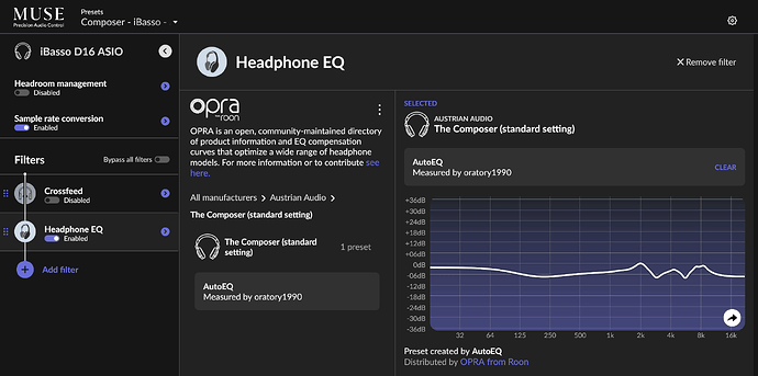

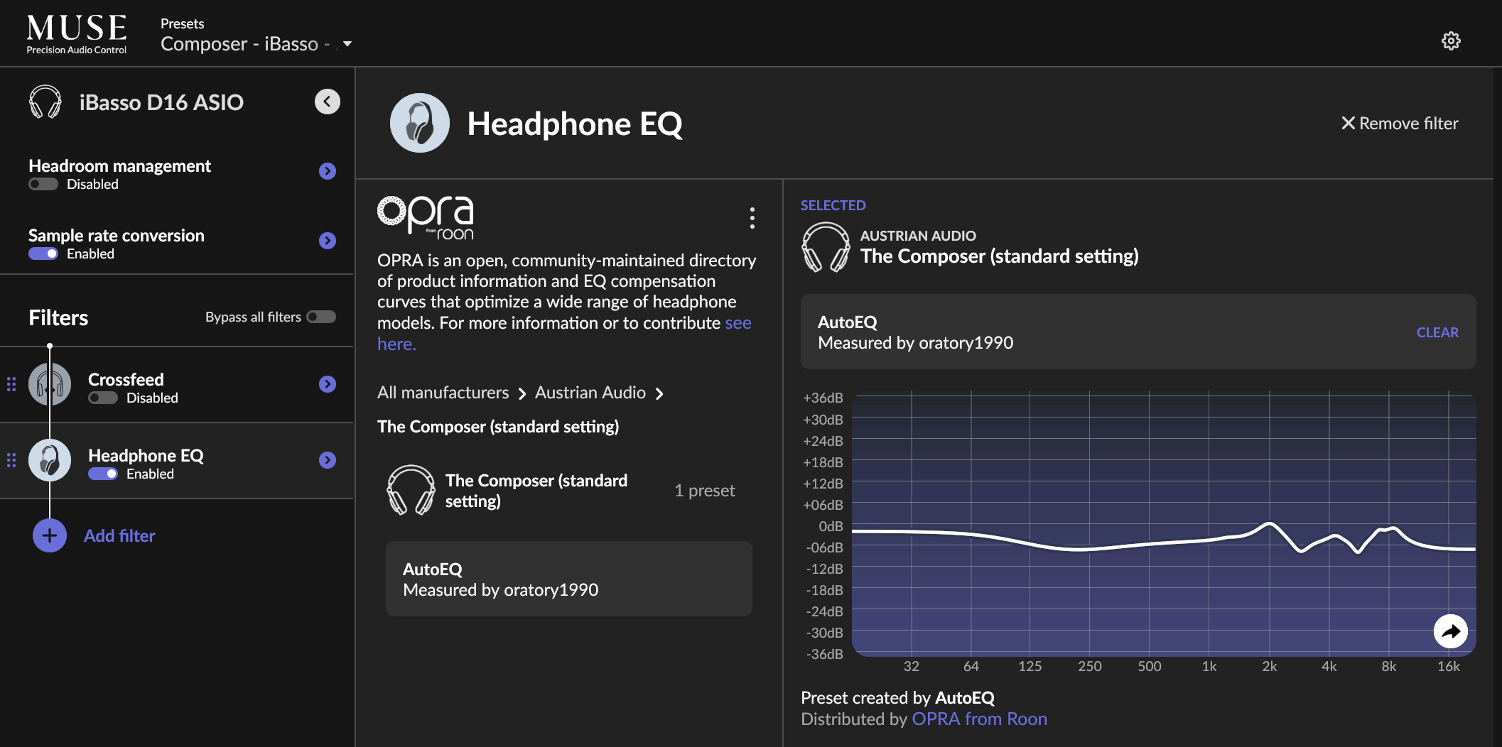

OPRA versus EQ settings - OPRA settings sounds better
Have done a comparison between OPRA and manual EQ settings.
Have adjusted Headroom to the same values so that they can be compared.
So in principle the settings should be the same.
BUT: The OPRA settings sounds better.
How can that be?

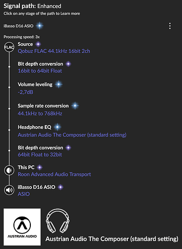

OPRA doesn’t disclose how many bands of PEQ is being applied. Maybe this is different? If it’s using the same PEQ engine not sure how it could be different unless some settings are not the same
Easiest guess would be that one is lowering the volume for headroom more than the other.
Won’t be an exact science, but a quick way to rule that out would be to record the output of both, and diff them. Just be careful to not change volume (either at input or input) between the two recordings.
How did you find out the exact EQ settings that OPRA is applying?

You can check the OPRA settings here, including the overall gain reduction.
I’d already noticed they didn’t match Oratory’s, for my headphones, and was confused, so thanks to @SukieInTheGraveyard for explaining that.
I’ve seen this question several times recently in other posts so forgive me if I’m stating the obvious!
You can click the right facing arrow in the visualisation box to create your own preset with the PEQ parameters of the chosen OPRA see screenshot…
Then you can tweak to your hearts desire! Bear in mind this is a PEQ preset for use within the PEQ parameters and won’t appear in the MUSE presets unless it is saved as such… so it will take on headroom, sample rate and other non-PEQ MUSE parameters for the preset you happen to be in at the time.
