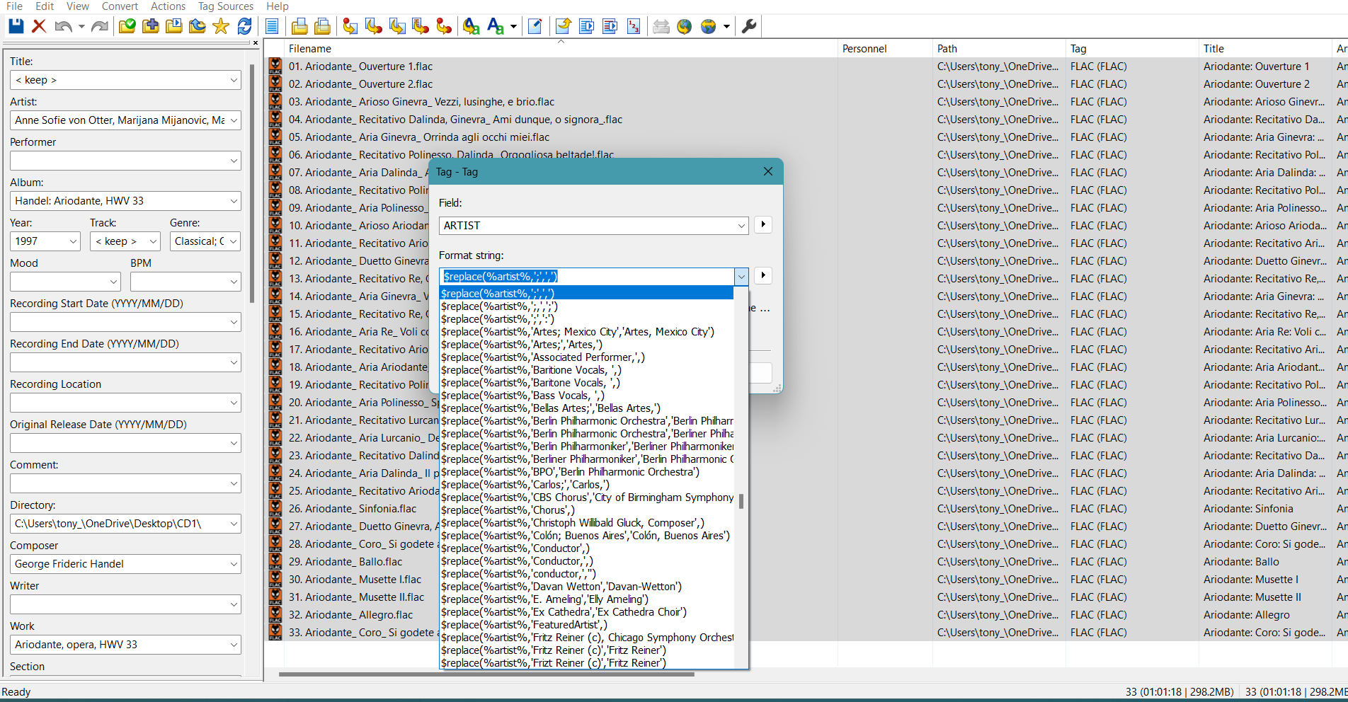

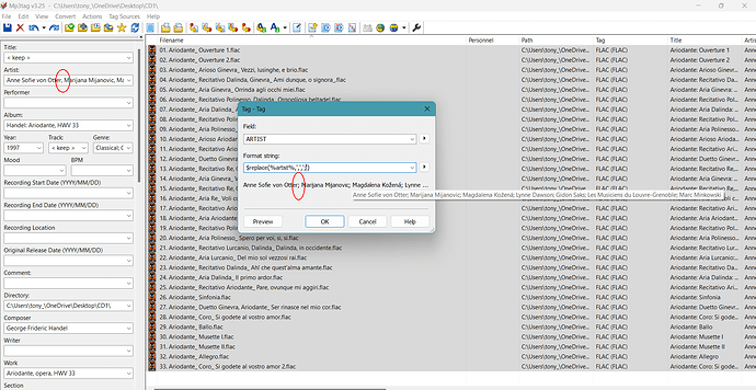

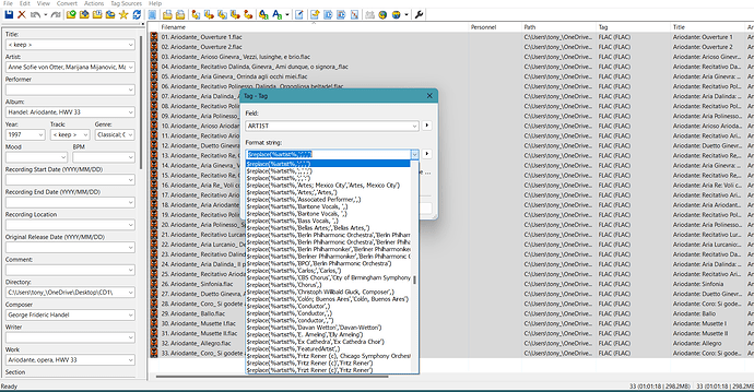

It will not be easy for sure. Unmerging artists in roon is not what you need to do. Or to be honest any editing in roon at all with a larger library if you can avoid it which seems to be your instinct. You need a 3rd party tagger like mp3tag which can batch replace tags at source. That is comma, hyphen etc. delimiters that roon doesn’t recognise with a semi-colon that it does.
For example, Opera metadata is plagued with this problem but you can use mp3tag’s scripting language to automate the substitution.
I would experiment with a few albums until you can see what the side effects are as you probably have built in other dependencies into the way you are using roon at this stage. Also, sometimes you want to retain the comma where that is part of the normal artist name or at least how roon has equivalenced it. You will have to experiment and fix the side cases you encounter manually or just make another script and run it across your entire library in one go as I do. Over the years I have found it necessary to build up a library of hundreds of mp3tag scripts I can draw on or slightly modify:
Remember. You can batch up these substitutions for entire directories with hundreds of folders or even your entire library which I routinely do. I also use roon’s’ editing features like artist merge as you do but much more sparingly than you seem to have done. Mostly it is to catch equivalences with more obscure artists that roon has missed. I don’t think a lot of these roon editing features scale very well with larger libraries and were probably not designed with the edge cases of larger libraries in mind.
