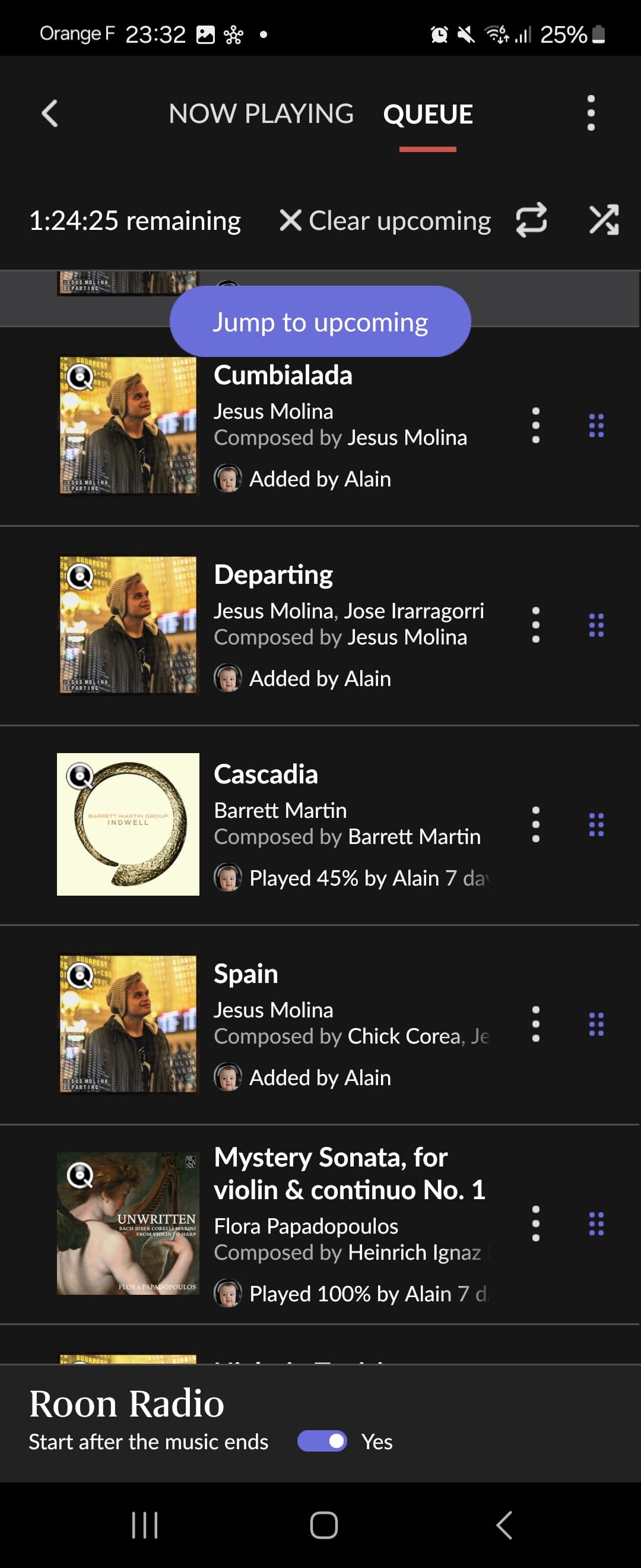

Thank you, @benjamin, for your response. As requested, I have deactivated all Chromecast devices to completely isolate the Primare SC15 network player. I reproduced the anomalies tonight between 11:29 PM and 11:33 PM. You will see that two tracks were played: the first by Leon Bridges (when a man cries) and the second by Jesús Molina (what is this thing called love). I replicated the problem 4 to 5 times on the first track and 2 to 3 times on the second.
It’s worth noting that while retesting, I discovered another anomaly. When I launch the album, the song queue is correct and in order. However, when the bug occurs, the subsequent songs in the queue are mixed with other songs that shouldn’t be there, as evidenced by the screenshots below.
I hope that this time the logs will reveal something. To remind you, this only happens with Qobuz. On these tracks, it’s 100% reproducible and occurs only on certain songs, not others.
