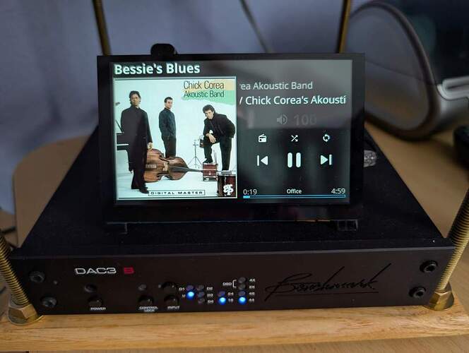

While not as small as the one you linked to, a 5" display works just fine.
It needs to be a DSI screen, not HDMI.
Beyond that most work fine (I use a waveshare 5" one) but there’s no guarantee and Harry doesnt support them since there are yoo many variants.
I’ve had one beta release that broke my non-official screen for no obvious reason (but not the official one). Next release was fine.
Well, I had to re-engineer the screen functionality because of the ‘almost-ready-display-2-support’. That also comes with another advantage: the possibility to ‘relatively easy’ add support for other screens, like the Waveshare ones.
Just sayin’ :wink:
Thanks Harry, since mine worked I wasn’t too fussed :grin:, but I’m certainly happy for it to become a “legit option”.
In my case it’s definitely an inferior screen (backlight never turns 100% off unless I manually solder a 1mm capacitor) but at 4.3" (the same size as the Pi) it is a much better mini player to disappear into a corner.
