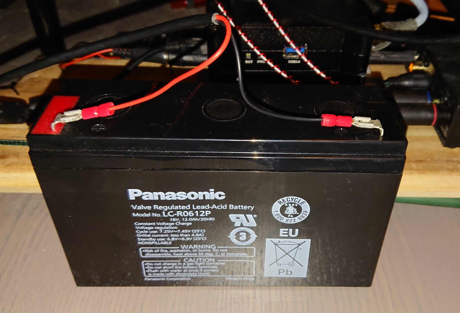

I experimented a little, and tried batteries as power, one 6v 12ah for the Pro-Ject DAC, and 4*1.2 rechargeable AA batteries for my transport (Allo USBridge). And I have to say I am very impressed by the result, far better than the old iFi iPower 5v I was using. The step-up in sound quality was very noticeable.
They batteries last more than one day, so charging them at night. And the lead battery is sealed AGM so safe to use indoor (or so I hope)
The battery is not as big as it looks on the picture, its about the size of a thick pocket book.
The only problem: I am unsure how the DAC will handle 1 - 1.5V over spec in the long run. Have to wait and see I guess.
Here is a picture:
Does it come with charging adapter? And what cables do you use to get it from the battery leads down to microUSB for the DAC? Can you share some photos. I was interested in this same Panasonic for something else.
Iâd measure itâs Vdc output if you can - in case itâs output is greater than 6Vdc. Just to be safe.
No cables came with it, I bought a 5.5x2.5 mm DC connector with cable, and a DC adapter -> micro USB, and then the 4.8mm clips that fits the battery connectors. Also bought a charger.
VC output is about 6.5v when charged, but the DAC seems to handle it. If you buy one, it would be interesting to hear a comparison with a good LPS (I only used iFi iPower 5v before and the battery sounds much better than those).
USB power specification allows up to 5.25Vdc.
Are you sure the DAC isnât switching to USB bus power because your SLA battery is over the limit?
If you unplug the USB cable, does the SLA battery still power the DAC?
Yes, I use the UpTone A>B connectors which have a âcut powerâ switch which I turn off (it needs to be on when detecting the DAC, but then its ok to turn it off). So the DAC only gets power from one source.

But I am just as surprised as you that the DACâs power input can handle over 6VdcâŚ
Which model charger did you get? Does the battery itself have any electronics to indicate low power (it needs charging)? Or is it just a basic SLA in that regard?
No indicator on the battery, but the DAC shuts down at around 4.5V so thats a good indication
but I have a multi-meter so can measure the DC on the battery (right now i have played it for 1.5 days and its at 5.1V so going to charge it tonight).
Cool! Iâll pick one up when I get a chance.
Loaded the battery when I slept, it has 6.7V fully loaded, but the DAC seems to work fine (and sounds very good). The only thing I notice is that the DAC gets a little warmer than usual, I guess some internal voltage regulators has to work harder.
Stick an LDO between the battery and the DAC; these operate with minimal input to output differentials, so 6V to 5V is achievable. A few quid could save your DAC in the long run.
