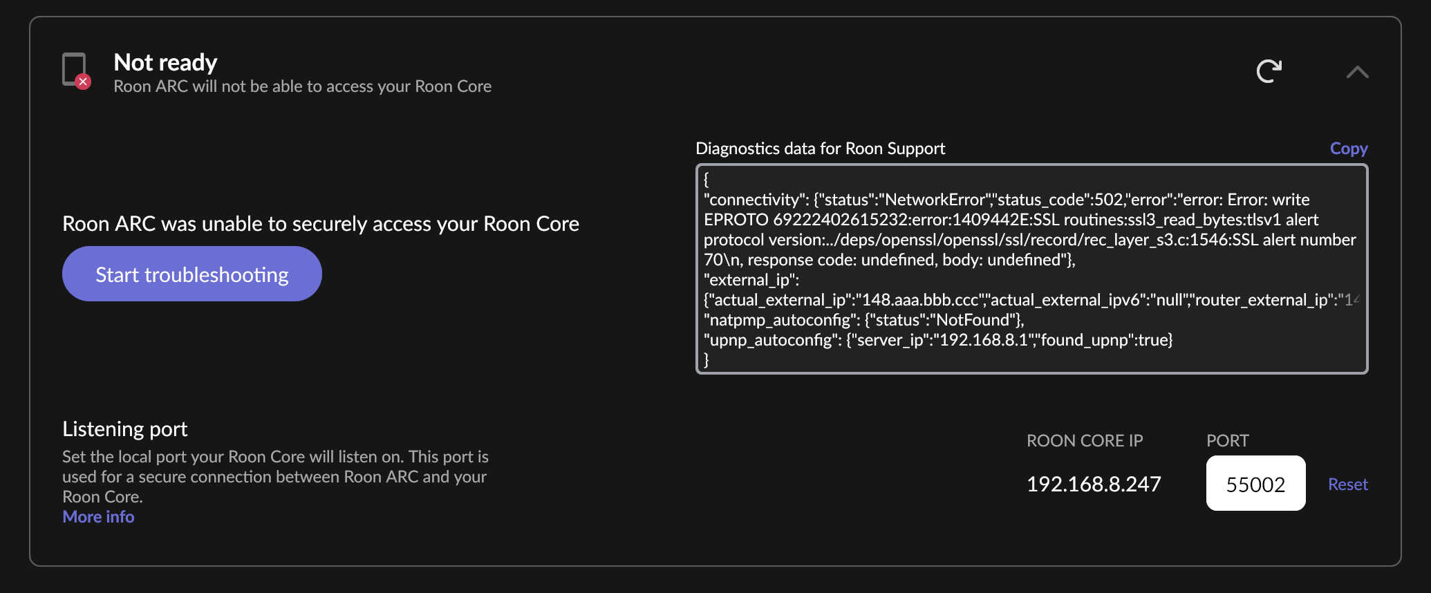

What is the exact port forwarding error message you see in the Roon Settings → ARC tab?
"connectivity": {"status":"NetworkError","status_code":502,"error":"error: Error: write EPROTO 69222402615232:error:1409442E:SSL routines:ssl3_read_bytes:tlsv1 alert protocol version:../deps/openssl/openssl/ssl/record/rec_layer_s3.c:1546:SSL alert number 70\n, response code: undefined, body: undefined"},
"external_ip": {"actual_external_ip":"148.aaa.bbb.ccc","actual_external_ipv6":"null","router_external_ip":"148.aaa.bbb.ccc"},
"natpmp_autoconfig": {"status":"NotFound"},
"upnp_autoconfig": {"server_ip":"192.168.8.1","found_upnp":true}

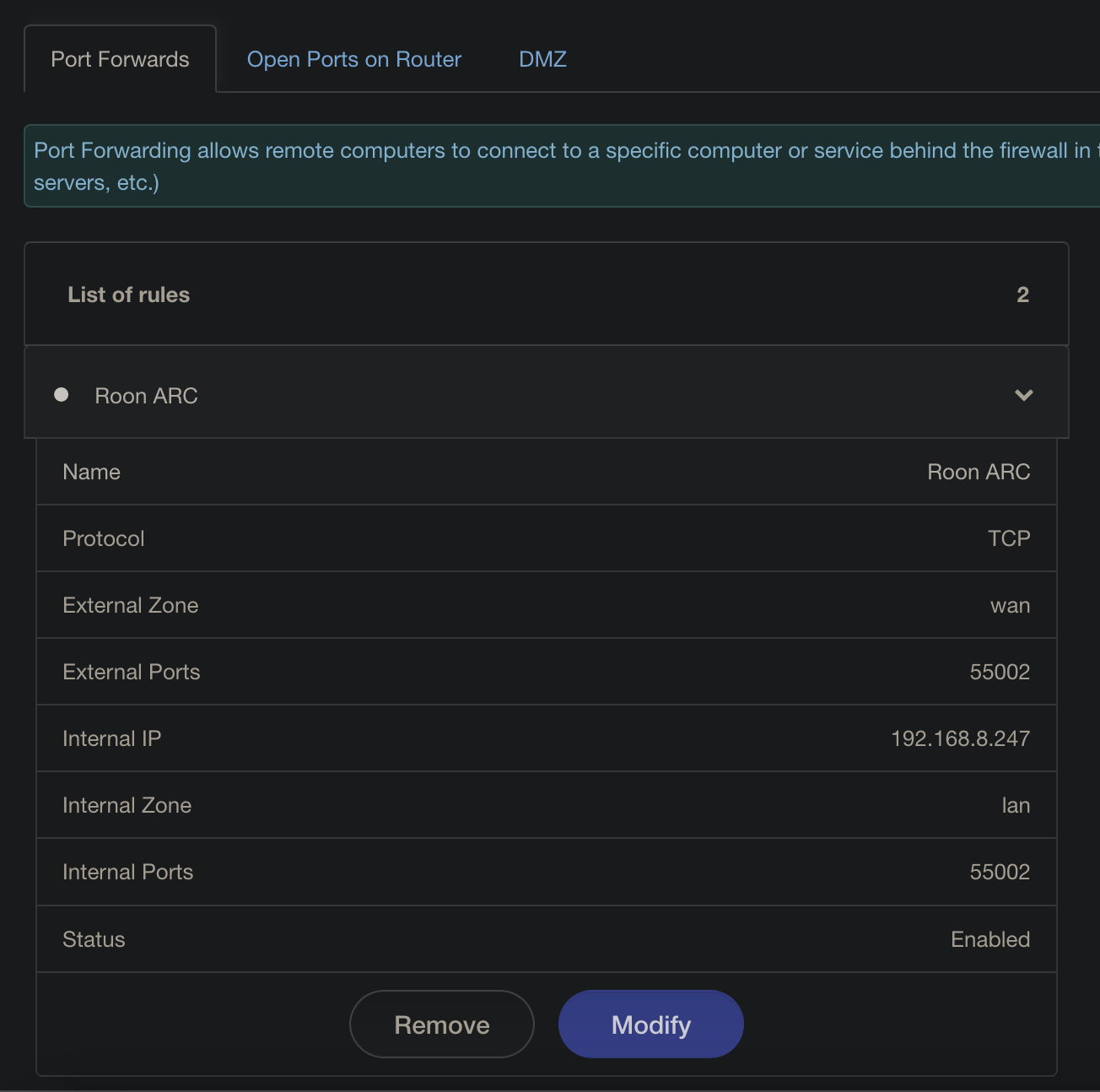

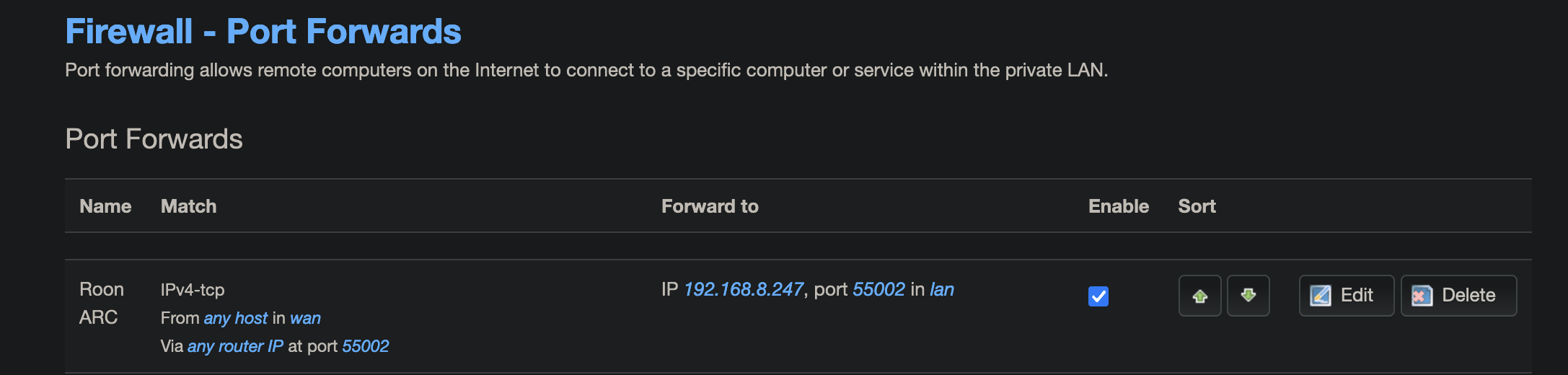

So, Roon ARC was working just fine on my previous router with very similar port forwarding settings running on an OpenWRT install on my old TPLink C7. Switched to this new Flint Router, running essentially the same software (Open WRT, LuCI and a custom UI provided by GL Inet, and it no longer works. I have attached images of the configuration in the router. The port forward is presented in the custom UI and LuCI.

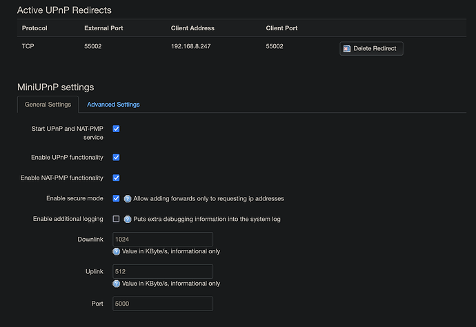

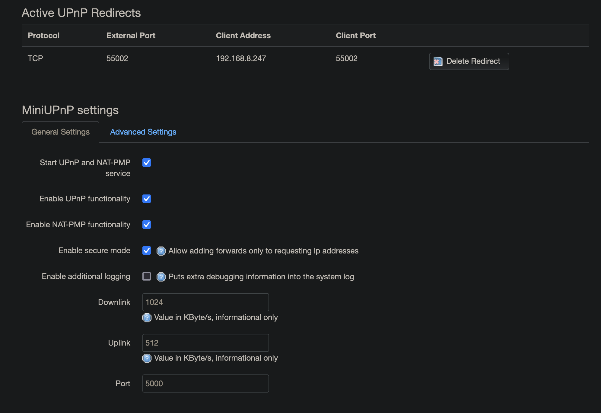

I should note on the old router I did not setup uPnP, just a manual port forwarding rule. On this one I’ve just turned on uPnP, then added the rule, and neither condition seems to alter the error message or allow ARC to connect.
Curious how I can further debug this, or if someone has this working on a similar router model. I haven’t seen anything up in these forums yet.
UPnP is there to create a rule. We have seen many cases on the forum where some router software does not deal well with it if UPnP is enabled and a manual rule is created as well. (Arguably it should, but in practice it often does not). I would suggest you try one or the other.
I have never seen this EPROTO OpenSSL error that you have though, so I don’t know what this is. I’d still try either UPnP or a manual rule, maybe it goes away.
I have tried both - turning on UPnP with no port forwarding and port forwarding with no UPnP. Hopefully Roon support will be able to triage or better understand the open ssl error - perhaps I need some certs installed on the router? Maybe this is something specific to the model?
